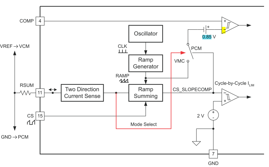

Could you tell me about inductor current dispersion in interleave.
Customer is troubled with the dispersion of the inductor current.
I have got three questions from customers.
1.Which parameter influences the dispersion of the inductor current?
2.Could you tell me Information with the dispersion of the inductor electric current?
3.DC offset voltage seem to affect the inductor current.
    Please tell me the variation of this offset voltage(typ=0.85V).
Please give me some advice.

  • Hello Yusuke-san
    I don't understand what you mean by ' inductor current dispersion in interleave' - is it something to do with operating two UCC28950 devices in a master / slave configuration ?
    I'm sorry but I don't have any information about the variation (dispersion?) of the 0.85V offset. In any case, variations in the CS offset (0.85V) won't affect the inductor current because the outer control loop will settle at a level that demands the correct current to satisfy the load condition. If the CS amplifier offset is a little high, the control loop (COMP) will settle at a level that is a little higher, if its a little low the control loop (COMP) will settle at a level that is a little lower. the COMP pin will settle at a level such that the EA+ and EA- inputs are at the same level. The error amplifier input offset (±7mV), the accuracy of the REF output (1.5V) and the accuracy of the output voltage potential divider will all contribute to the error in the output voltage setpoint.

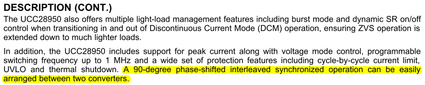

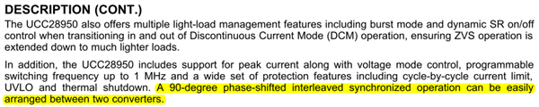

  • Peter-san,
    Thank you for your support.
    There are following mentions in UCC28950 data sheet.
    Customer want to know the recommended circuit of this.
    Could you tell me about recommended COMP and SYNC pin circuit in interleave condition.
    Yusuke/Japan Disty
  • Hi Yusuke-san,
    There is an e2e post that shows how to connect the error amplifier circuits for the master and slave.
    e2e.ti.com/.../161691
    The sync pin connections are covered by the datasheet on page 26.
