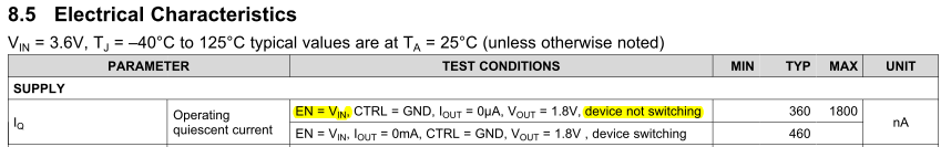

3.The following table is EN=High.
   However, it is '' Device not switching ''.
   What kind of state is this?
Could you give me your advice?

    3. Without load, the converter is not switching most of the time. Due to the leakage of the output capacitor, the output voltage decreases slowly. If the output voltage is below the target value, the converter starts switching, until the output voltage is at the target voltage again. As this is dependent on the used capacitor, the quiescent current while the converter is not switching is given in the specification.
