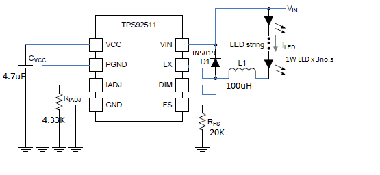

I have been using TPS92511 with following circuit configuration. It is supposed to drive the load of a single  1W LED with 350mA constant current at varying input voltage levels from 4.5V to 12V as per my requirement.
At input voltage of 4.5 V the LED is driven by 350mA and 3.2V drop across the LED, but as the input voltage is increased further to 5V and 6V the current is not remaining constant at 350mA. It increases to 450mA, 600mA respectively.
Kindly suggest me to improve the circuit configuration to attain constant 350mA  to drive single LED from a Li-ion battery source.
  • Often times regulation issues are noise related and can be from poor layout, improper bypassing, or both. Are you testing this with the TI EVM or your own PCB? Are you breadboarding it by chance? I also don't see an input capacitor in your schematic. Are you using one? What inductor part number are you using? If you are not using the EVM I would be happy to look over your layout for issues.

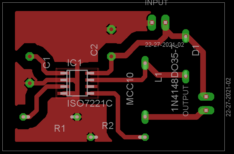

    Please find the PCB layout as shown in the figure below and suggest modifications to the same if any.
    The inductor value is 221 smd inductor ie 220uF
    Yes, we have included the input capacitor of value 47uF,63V. Please suggest whether any higher value is to be included.
    What will be the function of the capacitor at the input side?

  • Correction: Inductor is 221 uH and the capacitor is 4.7 uF.
  • The layout looks ok as far as placement goes, but I'm not sure about the grounding. Do you have a backside ground plane? All the forward currents through the inductor and diode will need a return path to the input capacitor and IC grounds. If you have a ground plane that should be ok, if not that could be your issue as it will generate a lot of noise. Also of concern is the IC thermal pad. I don't see a pad for it on the board. Do you have one? Is it soldered down correctly? If that pad is not connected directly to the ground pin beneath the device you could have noise issues as well.
  • Hi Clinton,
    It seems there were issues with the PCB tracks etching. We have ensured that there are no shorts between the tracks and the circuit is working now!
