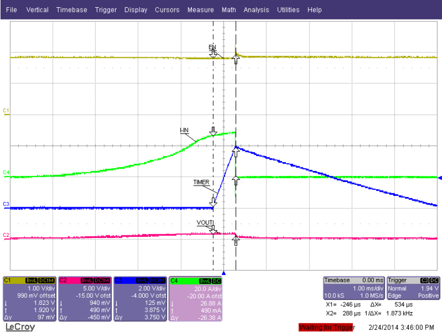

    However the issue is that cell C83 is not accurate. Cell 83 should be read from the SOA curve of the CSD17570 datasheet as described in the sample figure to the right in the spreadsheet.
    So you should check the MOSFET datasheet, look at the Vds curve at the point of cell C82 (4.232V) and then look at how much current the IC can handle for a pulse duration equal to the fault time (cell C75). However, the effective fault time may be higher than cell C75. Take a look at the actual waveform from the PMP9616 test results:
    From this waveform we see that the input current is ramping up due to the slow slew rate of Vgate/Vout. So if we estimate all the energy from the I-IN curve as an effective pulse of energy with a peak of 27A for a duration of t-effective, then t-effective would be around 2ms. So instead of checking the SOA curve for a pulse of 0.5ms (the original fault time), instead we should check the curve for a duration of 2ms.
    Also, at the time PMP9616 was created, the SOA curve of the CSD17570 was much higher (it was around 200A for a 0.5ms pulse at 4.2V Vds - which was used in the original calculations). The datasheet was updated after more accurate testing was conducted to measure the true failure point of the MOSFET.
    So if we review the design again to consider all worst-case conditions, we should change that one cell from the spreadsheet, cell C83 from 200A to instead look at the new CSD17570 SOA curve at 4.2V Vds for 2ms which would be about 50A. If we enter that value, we see the design may no longer be safe for a start-into-short circuit test at elevated temperatures.
    Instead, a stronger SOA MOSFET should be used such as CSD17556. It has much stronger transient power performance.
    As shown in the TI Design waveforms, the design does work to protect start-into-short at room temperature and using typical values. But it depends on the level of design margin required for the application such as whether to consider protection against fault conditions at elevated ambient temperatures.
