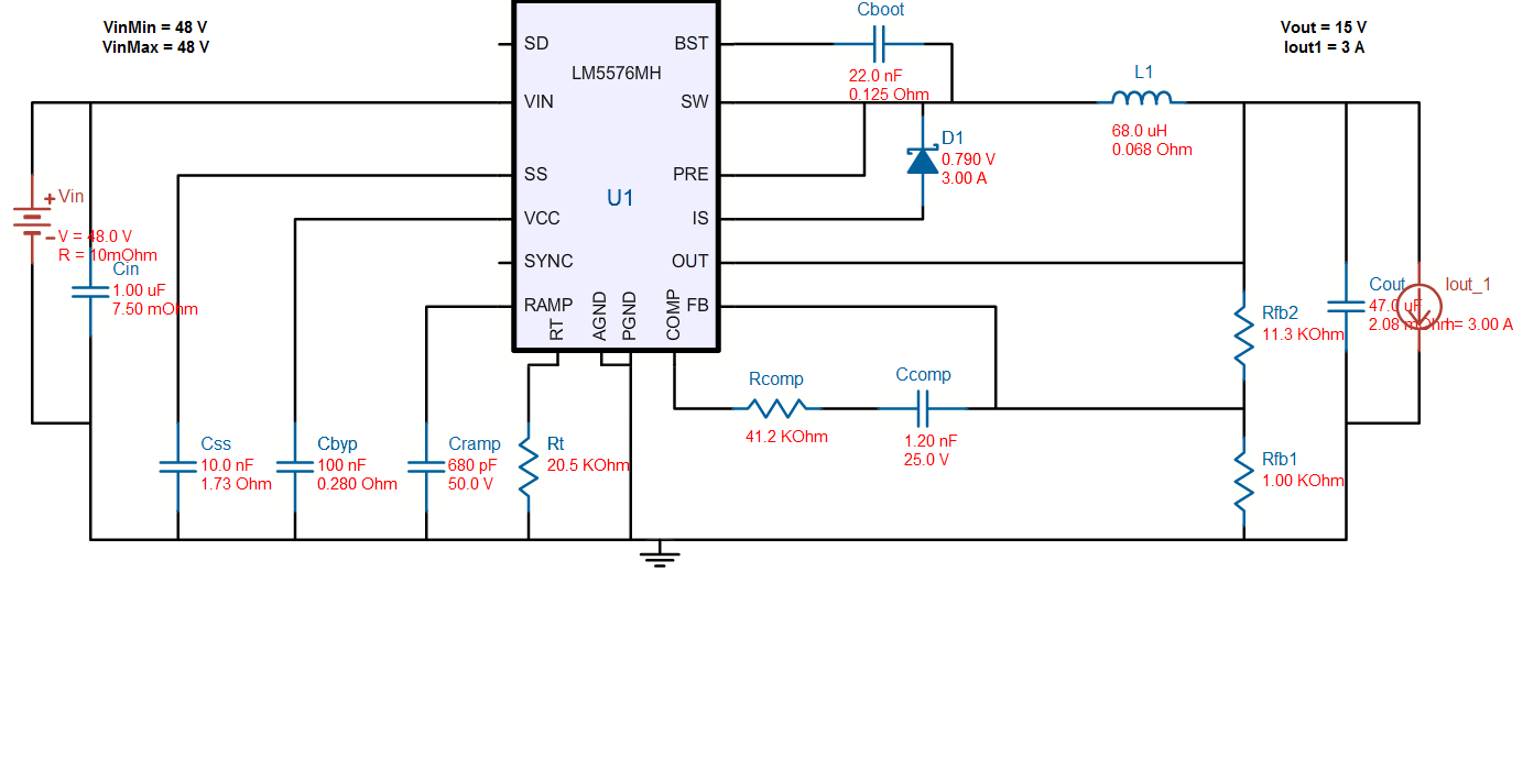

The evaluation board provides a 5V output with a 3A current capability. Is it possible to customize the EVM to provide 5V output with 3A?

You could just adjust the resistor but the part would have very high ripple current with the inductor on the board. If you go to the 5576 product folder on ti.com. On the right you will see a webench entry. Type in your paramters and you will receive an entire recommended bom and schematic. It will look something like this.
When I recalculated on webench, it recommended a larger inductance value. Some of the issues you are seeing might be because of instability.
Try at least a 47uH inductor.
