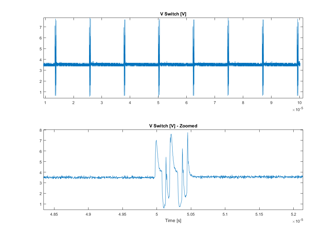

We recently ran into an issue where the 3.3V DC/DC seems to be damaged. Our board current consumption is 120mA @ 12V instead of ~30mA @ 12V. The DC/DC gets extremely hot, and after a while the 3.3V will periodically crash/reset (possibly the over temperature protection?)
I measured the switching output (Pin 7 - SW), which is shown below:
Instead of switching between 0 and 12V, it remains around 3.3V and then does a small burst between ~0 and ~8V. This clearly shows that this chip is malfunctioning. What i'd like to understand is how and why.

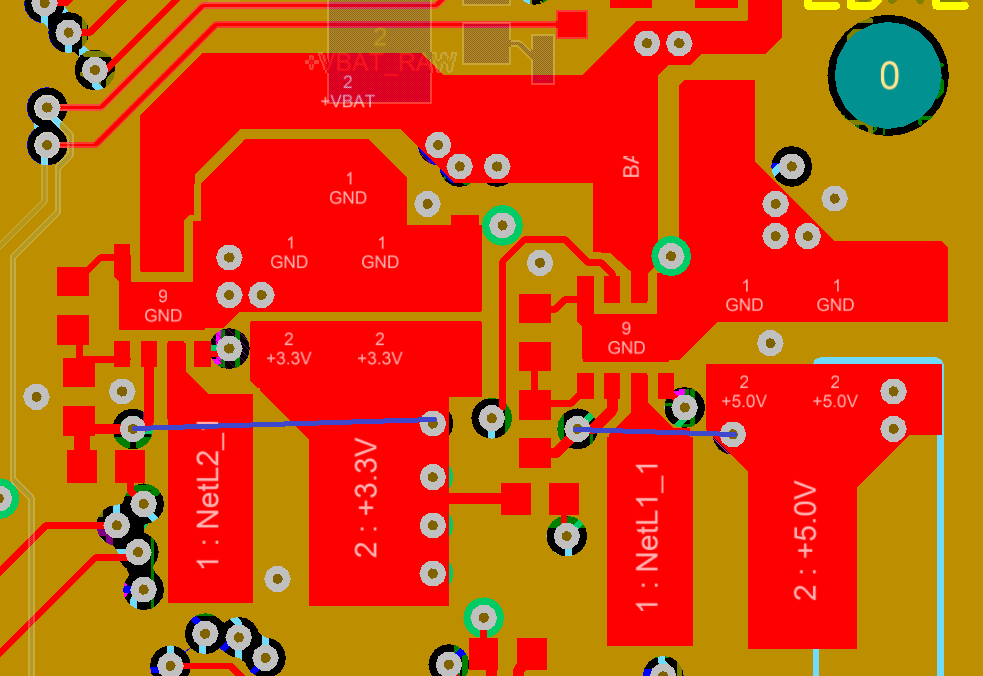

    The layout was slightly modified, with the main difference being that the feedback 3.3V is done with a trace, and not directly connected to the 3.3V plane.
  • Thanks for posting. I don't see your BOM in either thread. Can you please list the capacitor part numbers you used?

    It's difficult to read your 'waveforms' as they do not appear to be the output from an oscilloscope. But clearly, it is switching somewhat. I would relook at them with a scope.

    I did notice however, that the switching pattern greatly resembles the DC/DC low load mode. I ran a simulation with a load of 10mA which shows the switching pattern:
    webench.ti.com/.../SDP.cgi
    My questions is: How does the chip transition between the different modes (what's the criteria?), and can this give any insight in what might be wrong?
