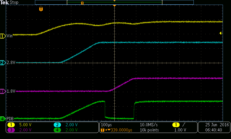

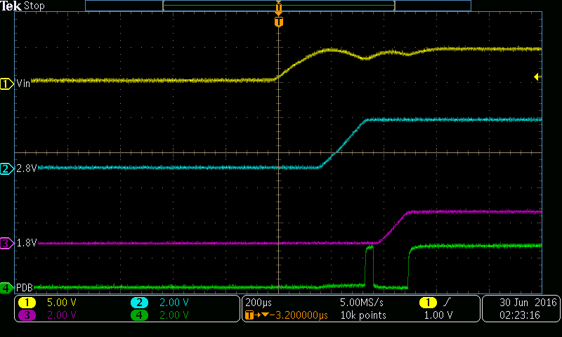

I am seeing an unexpected ramp and drop on the Power Good node of the TPS62171, which controls a RESET pin of a serializer. This PG output must be pulled up to 2.8V for a valid logic HIGH on a serializer, and the output of the '171 is of course 1.8V. I am currently using a 100kOhm pull-up resistor.
I need the 2.8V rail to come on before the 1.8V rail, and the serializer to come out of reset once the 1.8V has stabilized.
What happens is, when the 2.8V rail comes up, this Power Good tracks it, then drops to 0V, then steps up to 2.8V once the 1.8V output has reached its threshold.

  • Yes, this is expected since PG is high-Z when the device is disabled. You should be able to add a schottky from PG to EN to overcome this.

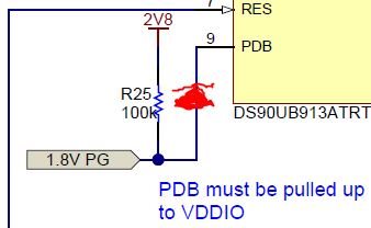

  • I've provided the updated and correct schematic. It shows the Power Good node pulled-up to 2.8V through the 100k resistor which allows the PDB pin to see the required 1.96V for a valid logic HIGHTIDA-01002 Schematic.pdf.
    You suggest to put a regular diode here:
    Is that correct?
  • No, the diode would connect PG of the 2.8V rail to the EN of the 2.8V rail. This way, when EN is pulled low by the 1.8V PG, the 2.8V PG is held low through the diode.

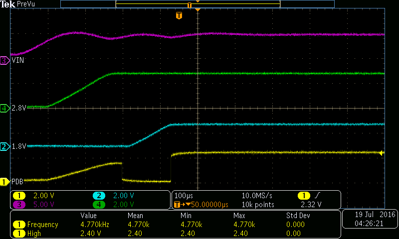

  • Below are some waveforms I took previously when I made added the schottky diode blue-wire into the system. I'm having difficulty including the .jpg/.png of the waveform, so I had to save it into a word docx file. Shown in following order are Vin, 2.8V, 1.8V, and PDB/PG. The PDB/PG waveform shows the delay between EN HIGH and PG control you describe.

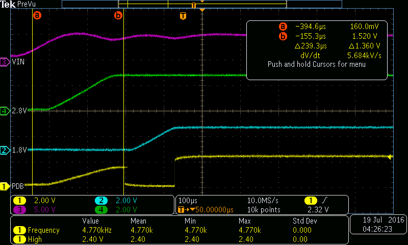

  • Chris,
    See the waveforms below. Looks like the diode kicked in around 1.3-1.5V, and the voltage at PDB was high enough to turn the device on. After checking with the cursors, it was around 2.3V.
    This looks good, and the ~1.5V is not high enough to bring the device out of reset. I ended up using 10k resistors for both. Thanks for clarifying that the drop occurs long as the voltage is above the forward voltage of the diode.
    It looks as though the 1.8V branch with the diode was a slowed down ramp of the 2.8V, given the additional resistance in that branch. Thank you again for this extremely educational and beneficial discussion here.
