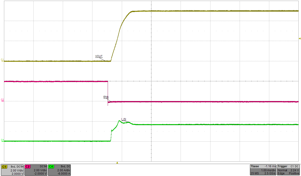

I'm finding at loads above 1.5A the TPS2421 faults at startup. Below that value there is no fault generated. Which rock to look under?
Vin - 5V
CCT - 0.047uF
Iset - 3A - 66.5K resistor
If I increase the CCT capacitor to something large to stave off the fault the PG led is green for ~500ms then the fault is still triggered.
