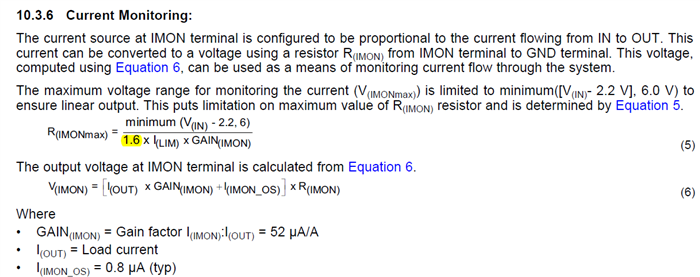

Hi Team,
I would like to know about calculation formula of R(IMONmax).
What does "1.6" mean?
I guess that it is the margin that added variability of I(LIM) and GAIN(IMON).
Therefore, I can use typical value of I(LIM) and GAIN(IMON).
Is my understanding correct?
