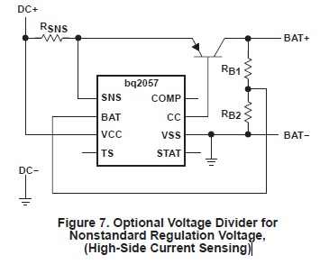

My customer use panasonic battery(2S1P) but its CV voltage is 8V. And due to they are familiar with bq2057 series so they would like to use bq2057C with external BAt resistor divider to implement this specification.
can you advise is it ok or any concern from you?

    Customer needs 8V battery , so bq2057W is not ok for this design. and in datasheet page11, only mentioned bq2057T and bq2057W can add voltage divider between positive and negative terminals. but didn't mention bq2057c can do the same thing. that's why customer is asking?
    And from another E2E discussion, e2e.ti.com/.../38095 (it should not use external resistor divider for bq2057c because of the internal logic, for example, SLEEP comparator will be wrong.) That's why I need to double confirmation?

    Why does the customer want to use the bq2057C instead of the bq2057W? I am working with the design team to look into using the C version at 8V.

    Due to customer needs to support 8V battery voltage, so I think bq2057W can't support it with datsheet figure7 application circuit.

    Figure 7 shows "bq2057", but the text above that in the "voltage regulation phase" discussion specifically calls out the bq2057T or bq12057W as being able to use the voltage divider to be able to set a nonstandard voltage. The T and W version are not available in all package types.

    We understand that BQ2057T and BQ2057W are able to set a nonstandard voltage, however based on the equation and simplified function block diagram, the outputvoltage regulation level can only be adjusted to higher voltage level than the original VOUT(REG) that specified in the data sheet. i.e. 8.2 or 8.4V.
    That is why we are thinking of using BQ2057 or BQ2057C with external voltage divider to achieve output regulation voltage of +8.0V.
