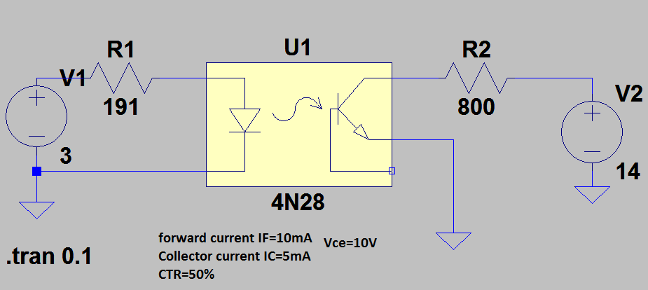

  • I HAVE SIMULATED 4N28 IN LTSPICE ...ACCORDING to the test condition
    VCE is set as per the test condition 10V. THE DATASHEET SAYS THE CTR FOR THE TEST CONDITION IS TYP 30%.
    BUT I AM GETTING MORE THAN THAT i.e 50%

    Finally, in your Spice simulation, the reason you get a 50% CTR is because I assume that is the value you have specified in the device CTR parameter field. It's displayed above under the opto device. For the 4N28, the datasheet specific CTR min of 10%, typ is 30%, and max is not specified.
    As I noted above, opto CTR is never precise or exact, and varies. Your electrical design needs to be sure that it can cope with the minimum CTR, then it should be ok as along as the actual CTR is at or above this minimum level.
