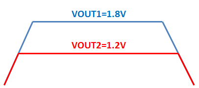

I understand that TPS62140 can set the simultaneous start up (VIN1=1.8V and VIN2=1.2V).
Can this device set the simultaneous power down?
Could you please let us know if you have any idea?
[The sequence that we need]
Kanemaru
  • The tracking down behavior should be explained at the top of page 17.
    The TPS62135 in PWM mode supports tracking down.
