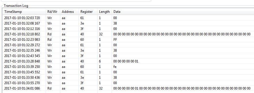

Hi all,
We are working on a design, in which BQ34Z100-G1 battery monitor is connected to Arduino micro-controller.
We are trying to change the configuration of the battery monitor by changing some registers of the data flash. We are able to read the data flash registers correctly, but the write back is not working properly.
We are getting a checksum value - 0x00, after writing the calculated checksum.Because of this checksum issue, written data into flash is not reflecting when we read back after a reset.
Please find the attached log (battery_monitor.txt) for details.
We tried to read the firmware version register (Sub Class ID 56 , Offset 4). This returns value - 0x00.
Is there any issues with the default firmware present inside the battery monitor as suggested in this e2e link ?
Please point us to possible causes for this issue.
Looking forward to valuable suggestions.
Avinash
  • Here is the transaction log to update the Firmware Version to 0001. The new checksum will be FE. I read SubClass 38H. Changed the Firmware Version parameter and the read SubClass 38H to verify that it has changed.
  • Hi Thomas,
    Thanks for the response.
    We tried to change the firmware version by writing 0x0001 to Subclass ID 56 (0x38) , offset register 4.
    But this change is also not getting reflected when we read back.
    We have attached arduino code & corresponding logs.
    Can you please look into this & suggest us on how to proceed further ?
    Looking forward to your valuable insights.
    We have put the source code and log files below.
    Code

    Log file
    Read Start
    starting 32 bytes read
    0
    0
    0
    0
    0
    0
    0
    0
    0
    0
    0
    0
    0
    0
    0
    0
    0
    0
    0
    0
    0
    0
    0
    0
    0
    0
    0
    0
    0
    0
    0
    0
    Read Complete
    Reading checksum
    FF
    Starting write
    0
    0
    0
    0
    0
    1
    Write completed
    Writing checksum
    Checksum written
    Read back after write
    0
    0
    0
    0
    0
    0
    0
    0
    0
    0
    0
    0
    0
    0
    0
    0
    0
    0
    0
    0
    0
    0
    0
    0
    0
    0
    0
    0
    0
    0
    0
    0
    Reading checksum
    FF
    Read Complete
    Avinash
  • Your code looks correct. You could check the I2C transmission with an oscilloscope to make sure that the device is ACK'ing the bytes. Maybe the address should be AA instead of 55.
  • The program is written for 7-bit I2C Slave address thus address is 0x55 rather than 0xAA.
    Also, we are able to read the data flash registers & corresponding checksum properly.
    This confirms that the I2C communication is proper.
  • Hi Avinash,
    Thanks for the clarification. As Tom said please make sure the address on the scope capture from the micro matches the address on the scope capture from bqStudio. Do you have an I2C sniffer? That would also be very useful for debugging your I2C transactions.
  • Log.docx
    Thanks Damien, log file with response above.
