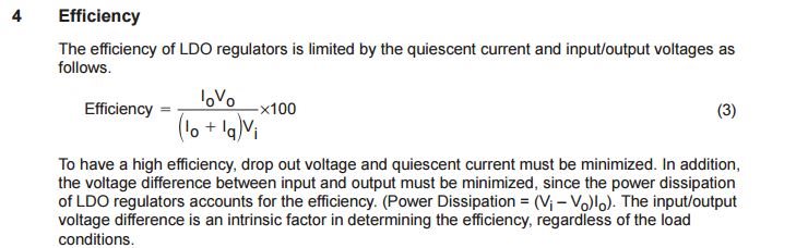

We are using TLV733p in our circuit. Our application is below,
Input - 5V
Output - 3.3V
Output current - Less than 20 mA

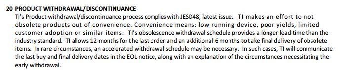

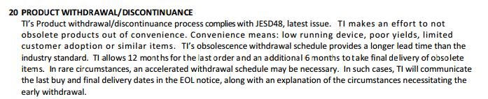

we need to know what is he efficiency we might expect. Also please provide Life cycle/ Expected year of getting obselete.
