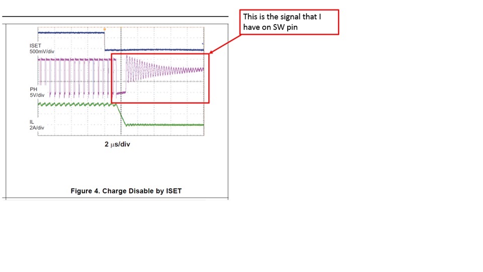

I'm triing to make a 3s2p li-ion charger, but it  simple go to charge disable according to the figure4 on page 13 on the datasheet (slusad2c). i am conecting in this order:
1.-connect the battery
2.-conect the power supply(15.4 vdc),
3.- aprox 2 second Vin is conected, status pin is low(this drives a led on), and at the same time i get the signal on SW, same as the figure 4 page 13 on datasheet (slusad2c)

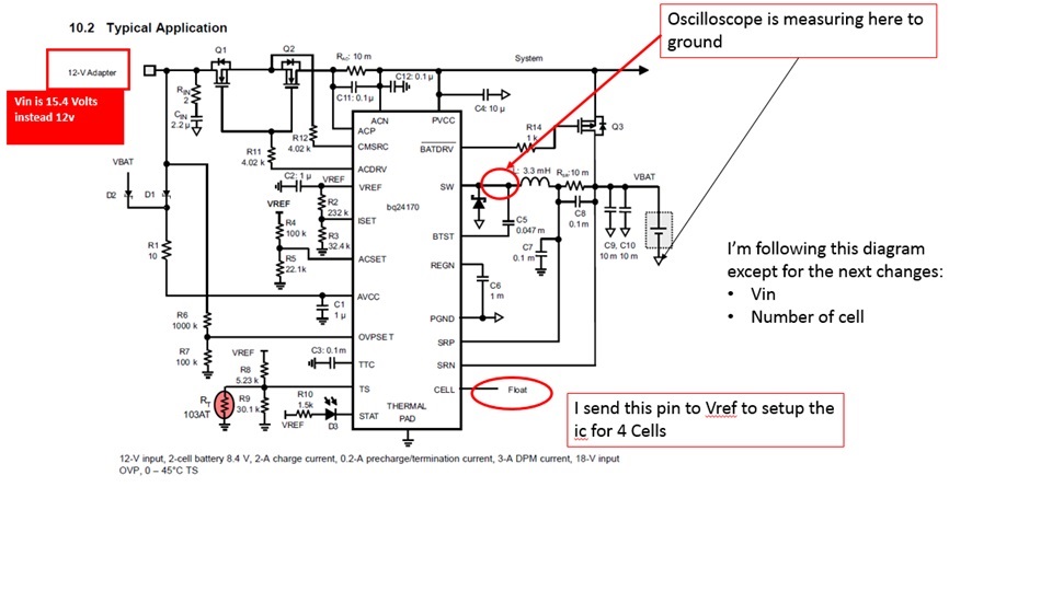

  • Ok lets see know, i attached a powerpoint file indicating where im meassuring with an osciloscope, and the diagram that im following, hope this can clarify the problem.

  • The setup con CELL pin is for 3 Cells not 4. Sorry

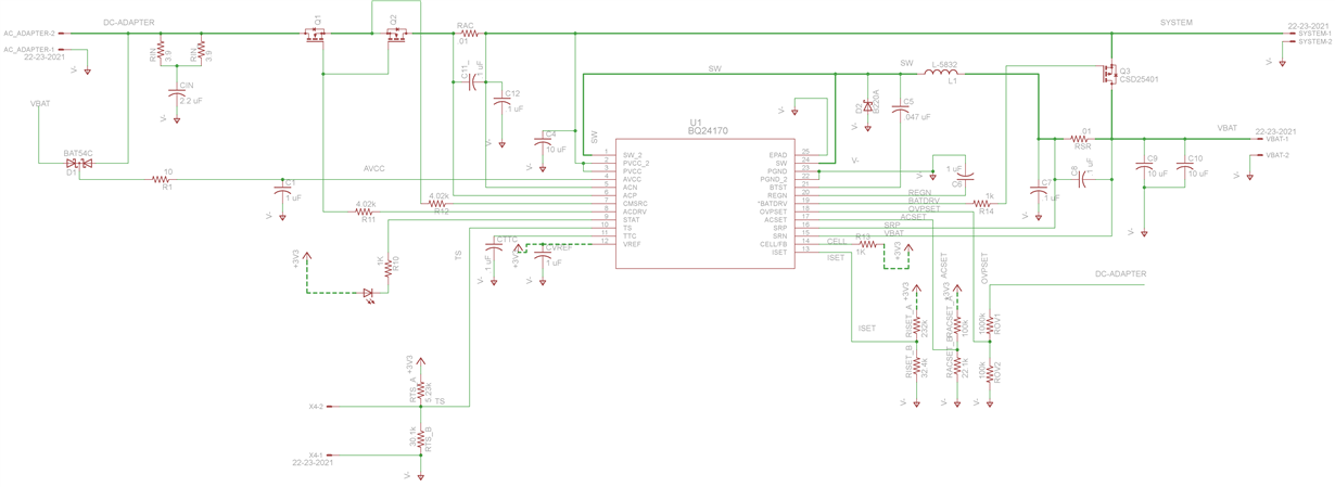

  • It looks like a Layout problem. Can you provide your schmatic, Layout and plot the SW, SRN, IL, PVCC waveforms?
  • Here is my shcematic and my board files,
    Note.- im using one layer board , made in house, with a cnc router machine.
  • Hi.
    It seems layout problems.You should layout by hand and follow Layout Guidelines(the Page 31 of the datasheet ) below:

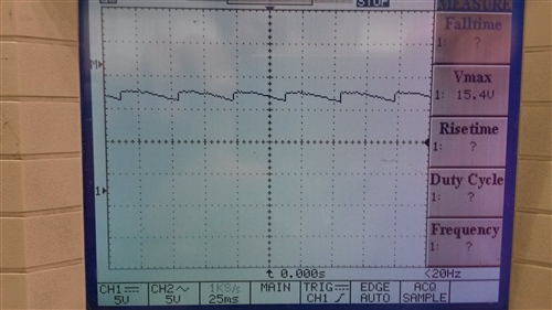

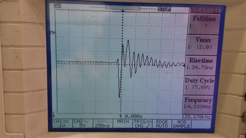

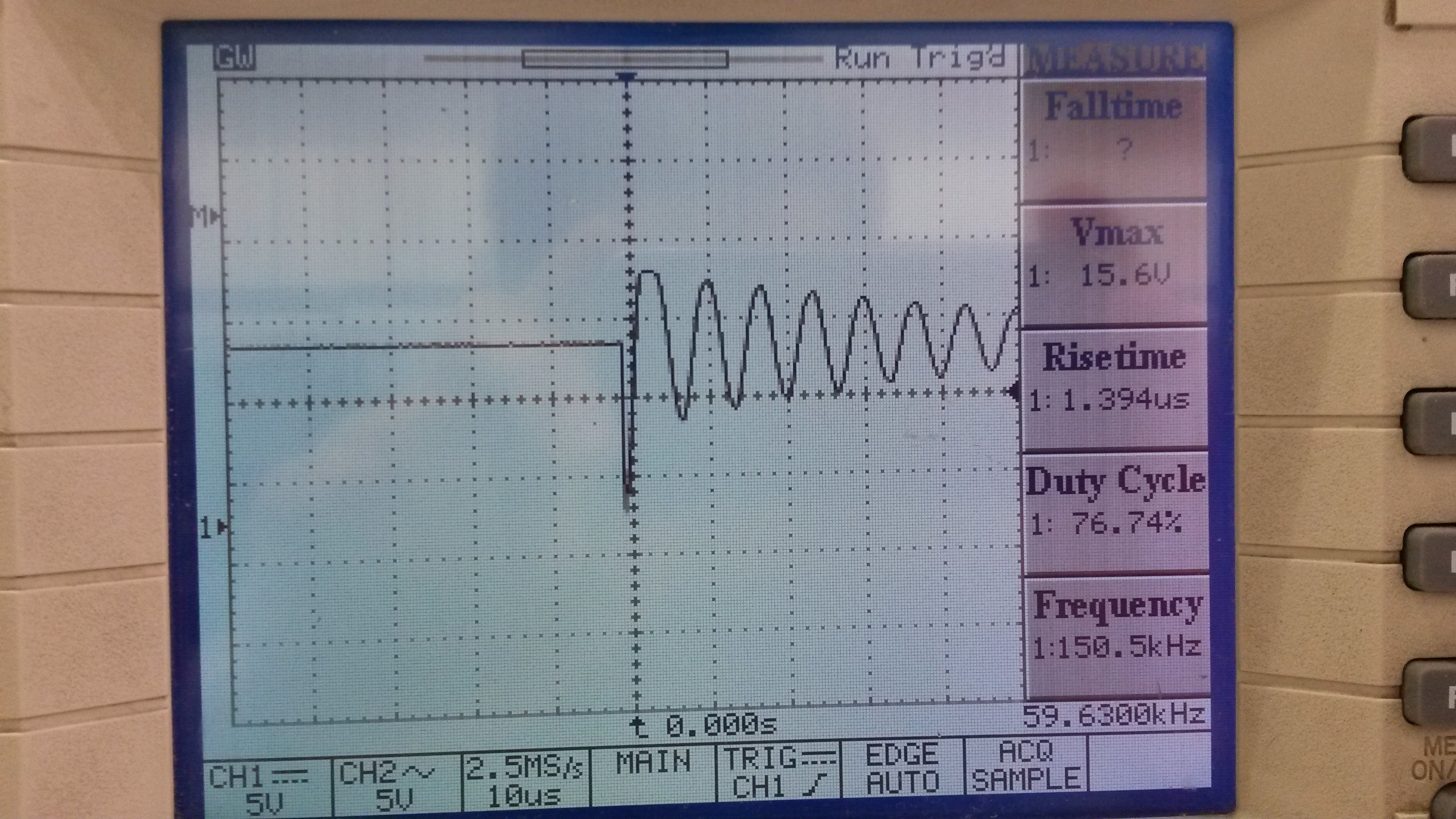

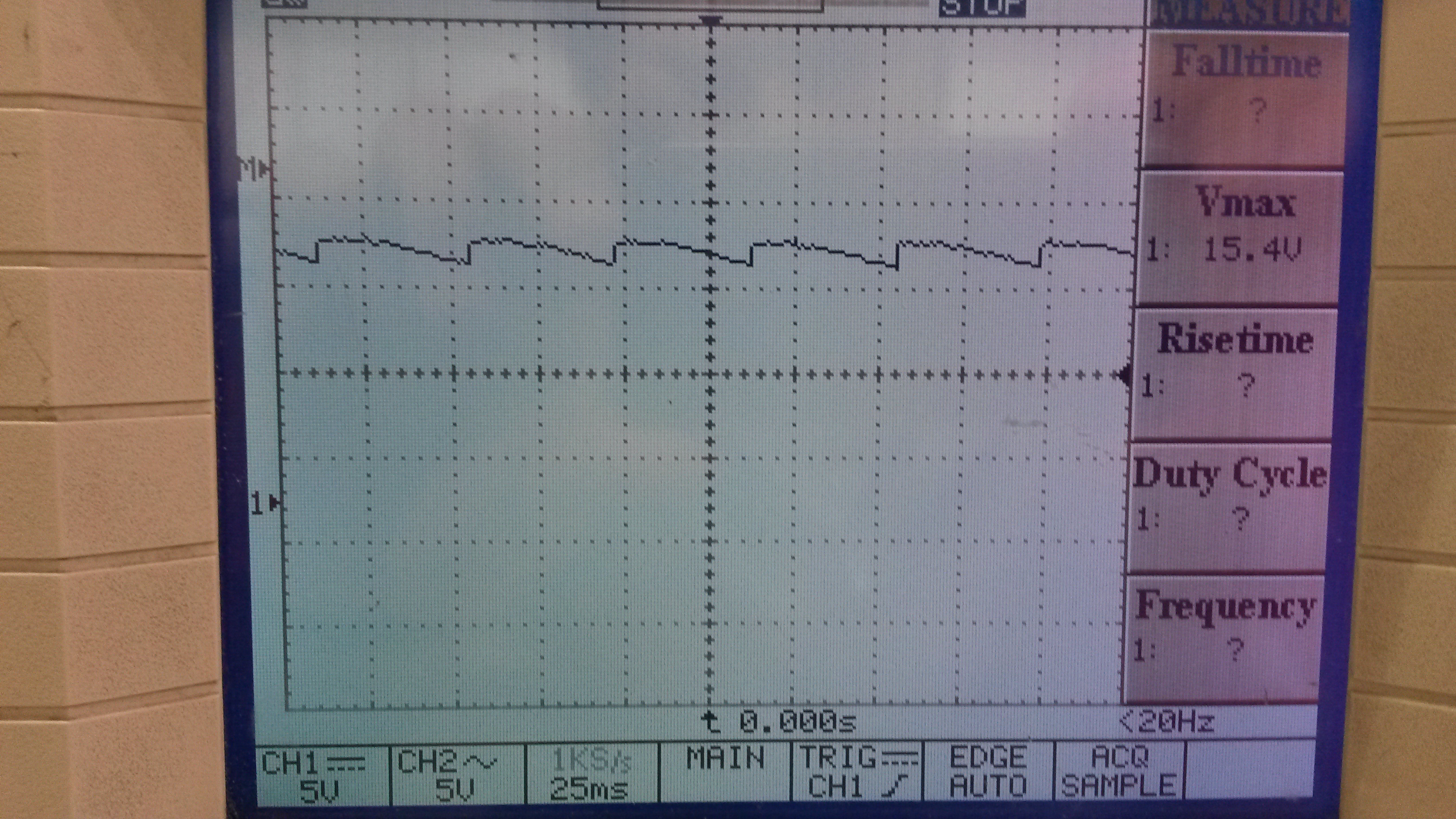

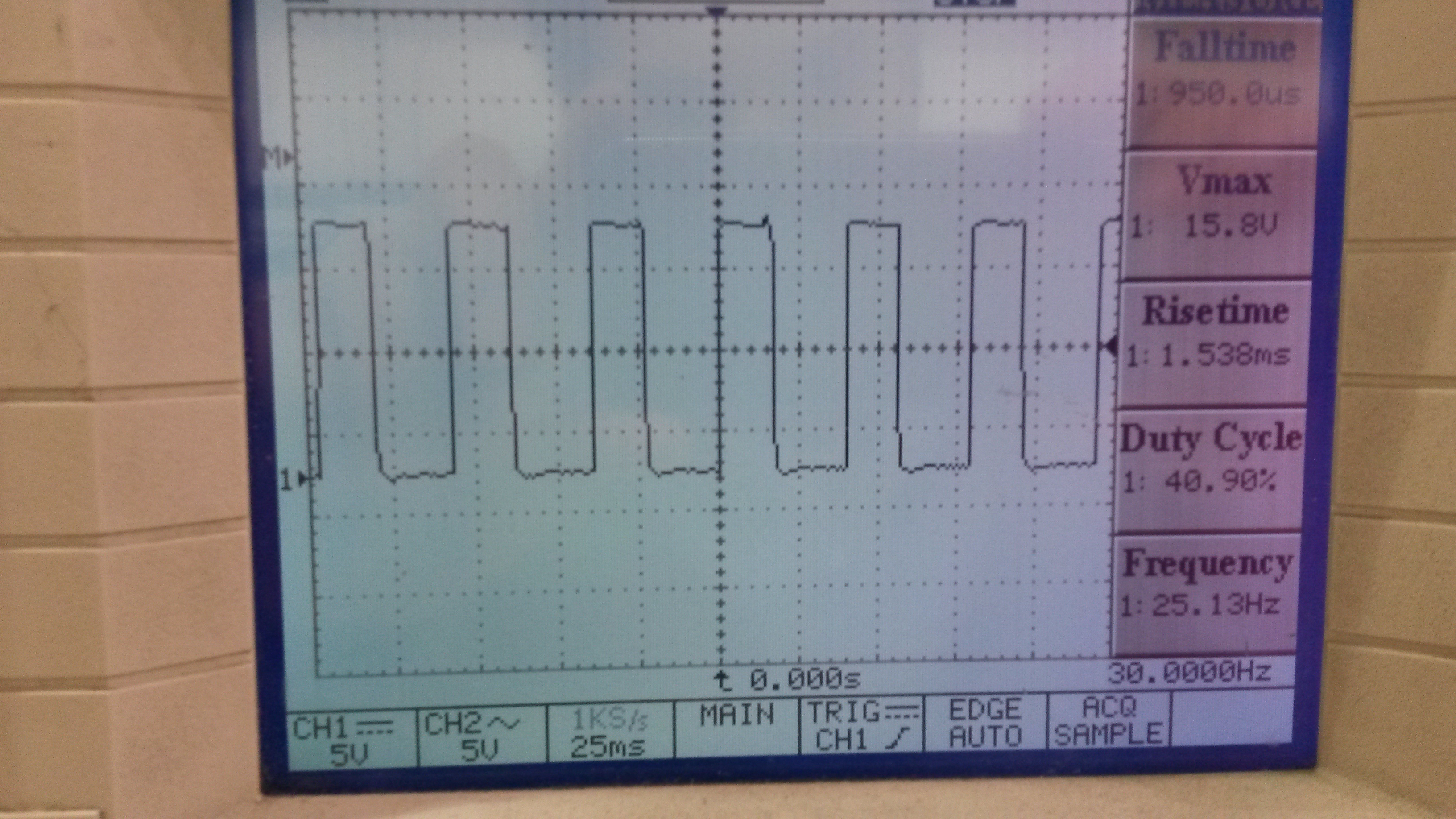

  • SW WAVEFORM:
    SRN WAVEFORM:
    PVCC WAVEFORM:
    And this signal is looks weird for me:
    ACDRV:
