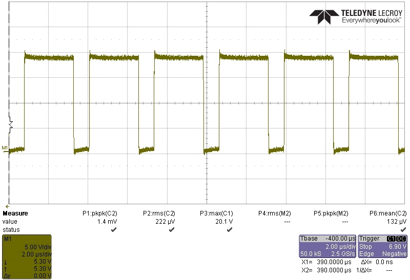

For instance, at 14V, I've this when I lood to SW pins of the component: (stable and almost constant => under 20OHm load)
When I increase the input voltage the duty cycle start to oscillate and the frequency seems to change. On the table it seems to work but as soon as I place it in our product and under temperature after short time under high load the regulation stop completely working (I got lower than 15V instead of 18V). I need to switch OFF and ON to make it work again ....

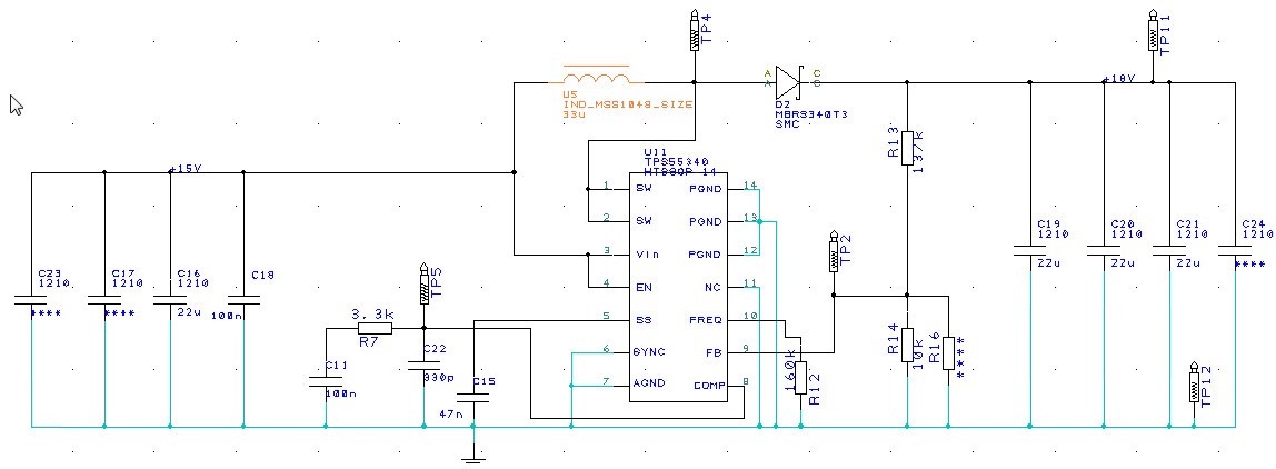

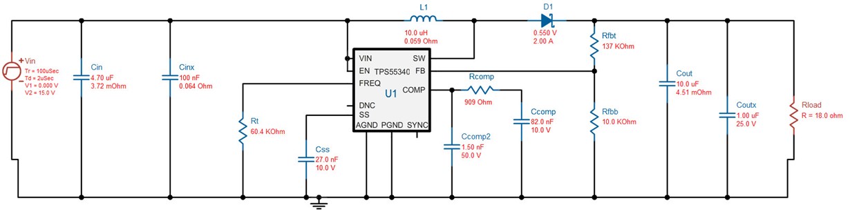

    Here is my last trial made:
    Regarding your comment it's what I see. Even from 14 to 16V with a load load is okay, it's when I place the high load that the behavior appear. Depending of the compensation it could be "stable" from 15 to 16 and not below and the contrary ... But it's always stable with a lower load.
    Regarding the duty cycle, based on the calculation It should be far away from the limit => Calculation said Dmin 14% and Dmax 24% ....

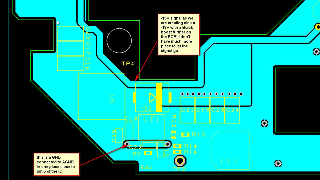

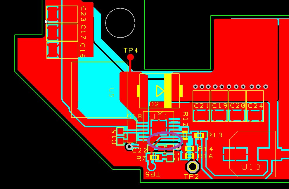

    Here is the layout.
    No I didn't try with a EVM ... +15V arrived on C23 and +18V should be on C24.
    Do you think is a layout issue ?

  • hi Fabien,
    I'm very sorry to tell you that with this layout you can't go anywhere  :(
    there are a lot of weakness, the worst one is the path from the inductor / diode node to the drain of the booster FET: this you routed as a normal signal trace, introducing a very high Z that affects the system perfomance...
    please see the comparison of the trace I mentioned w/ the EVM layout:
    I would recommend you to get an EVM, validate the bom and then re-do the layout in according to the guidelines...

    Thanks for your feedback.
    I've ordered a EVM to see if it will work in our case => TPS55340EVM-017

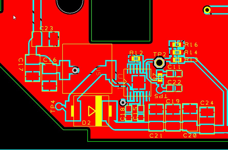

    In the meantime I've updated the layout. Do you think is it better ? Anyother comment or big mistake ?
    U13 is a Aluminium capacitor in case of ...
    Thanks.
  • hi Fabien,
    yes I have comments/feedback on that...
    I will be back to you asap...
    KR
    Vincenzo
  • hi Fabien,
    please find in attachment my comments plus a general guidelines for DC/DC switching converters
    if you have questions, just ask
    KR
    Vincenzo

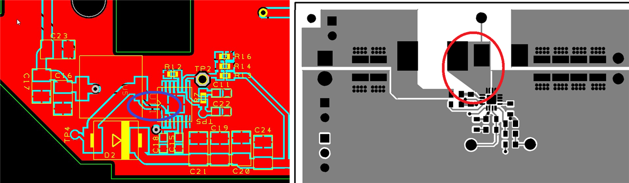

    I have only one question based on your comment is about:
    " Don't route signals under the pad" => where ?
    I've made a 2 layers PCB. Could it be an issue?
    On the Bottom there there is no signal, except those:
    Thanks.
    Fabien
  • hi Fabien,
    I meant the trace I highlighted here:
    you can just flip 90degrees CW the block C22 / C11 / R7...
    4 layers would be better from noise point of view, but if the board is not super crowded and as long as you provide enough GND copper, two layers pcb is ok...
    please remove the thermal relief to the vias (the key points that connect the various GND lands)...
    KR

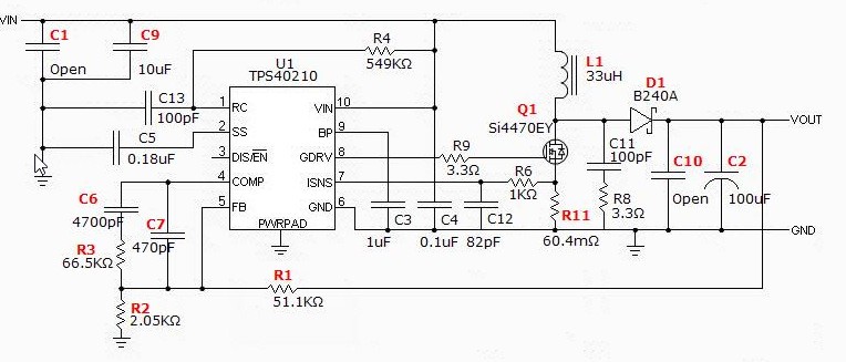

    Like this: (using a TPS40200 based on PMP4589)
    I want to improve the layout to this.
    Is it better?
    I try to follow the recommandation but as all are invert (the VDD is connected to the GND), I'm wondering If I'm doing right ...
    Your comment will be appreciated.
    Thanks.
    Fabien
