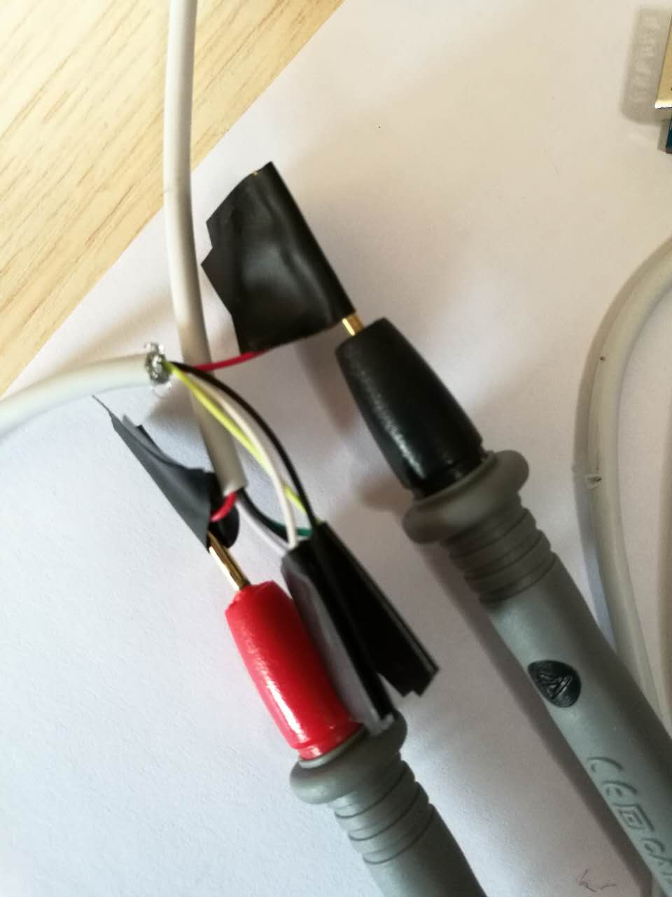

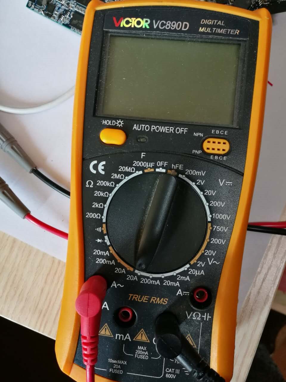

The current is measured with a multimeter, as shown below (only cut the VBUS wire and put it into the multimeter).
I didn't use any USB current monitor because they may support QC2.0\QC3.0\BC1.2, which will interfere the test.
I use a 2000mAH 1C battery. The battery is first depleted and charged with 500mA for 20 minutes before the test, to make sure it's not in the precharge or const voltage section.
No REG was written, so HVDCP_EN and MAXC_EN are both enabled by default.

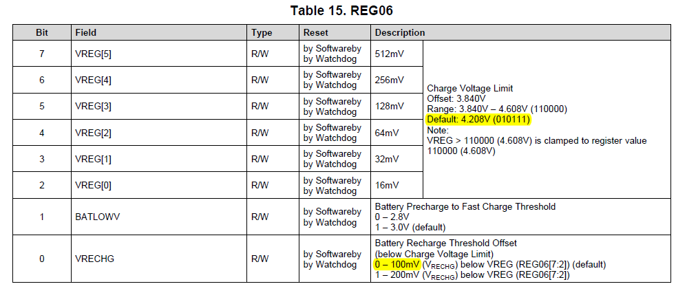

  • What is VBATREG register setting?
  • The registers were never written.
    I just read it out, It's the default value 0x5E. The same as the default value in the table.
  • Frank,
    Then you are in constant voltage mode and the current is already tapering down.

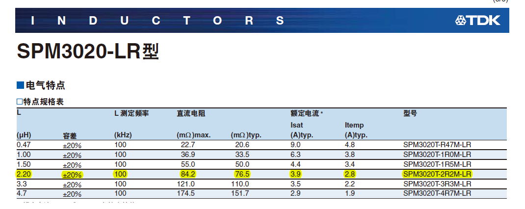

    The only other variable would be the inductor.  If not using a TI EVM, is your inductor current rating high enough (20% greater than your input current limit)?
  • Hi Jeff,
       1. The ICHRG is 2.048A, I never changed it.
       2. The system load is 150mA. VCC source provide power to the board without battery, the current is 150mA.
       3. Since the Ilimit=350/220=1.6A, and the ICHRG is 2.048A. The actual IBAT cannot get 2.048A.
            I mean the actual IBAT may be estimated by eff = POUT/PIN = VSYS*(IBAT+ISYS)/(VIN*IIN).
       4.  The inductor I use is SPM3020T-2R2M-LR, I think it's enough for the 1.6A input current.

    The "Fast Charging" doesn't tell CC or CV mode.
    Does it judge by VBAT==Vsys? Or does it judge by VBAT==Charge Voltage Limit?Or others?
    Frank
  • When V(BAT) = VBATREG, you are in constant voltage mode.
  • Do you mean by BATV==VREG?
    BATV is in REG0E
    VREG is in REG06
  • My board's input line is highly resistive (R=0.8V/1.103A=0.725).
    What do you suggest is a reasonable resistive?
    R<0.3 ? R<0.2?
  • VREG is BATREG=battery regulation voltage. BATV is the ADC measured value at the BAT pin.
  • R<=0.2ohm is not uncommon.
