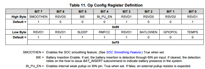

Can you please let me know the recommended BIN pin connection in case of battery detection is not used?
Can it be left open?

bq27425-G2A / Using with pulled down BIN pin to GND always
