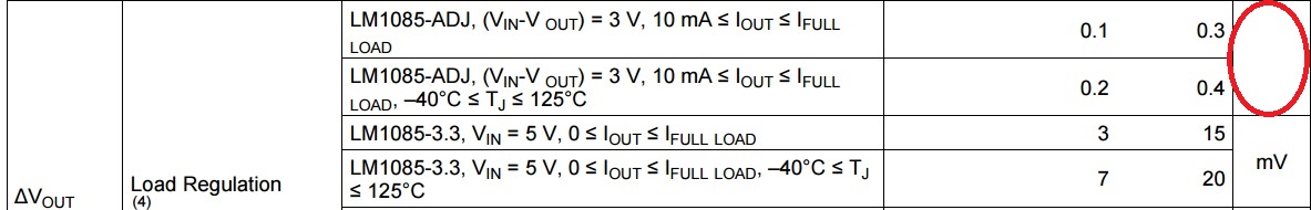

Hi.
I use lm1085adj.
Vin = 6.3 V.
Vout = 3.3 V.
Max load regulation = (| Vmax_out - Vout |) / Vout * 100%   = 0,3 %   It is right?
3.2901<Vmax_out< 3.3099  It is right?
The datasheet does not have any information about the units. No information about how this parameter is measured.
I correctly calculated the value of load regulatioun?
I really hope for your answer
    Yes, looking at the front page of the datasheet I see that it lists the typical load regulation as 0.1% and since 0.1 is the typical value listed in the Electrical Characteristics table that tells me that the unit column should have a % sign in it. Sorry for the confusion.
    Also, yes your load reg formula is correct.
    -Kyle
