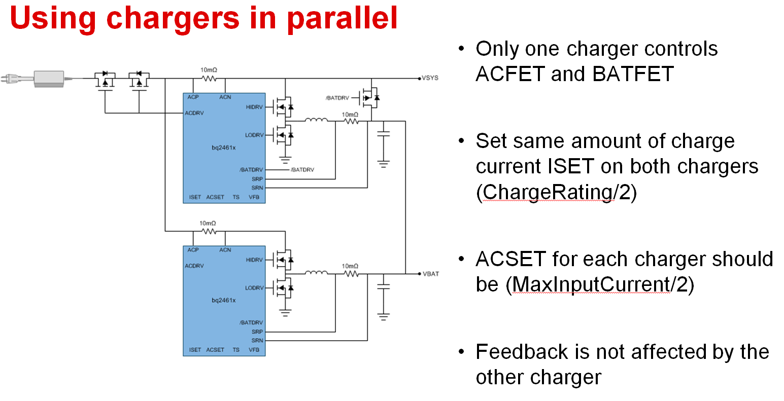

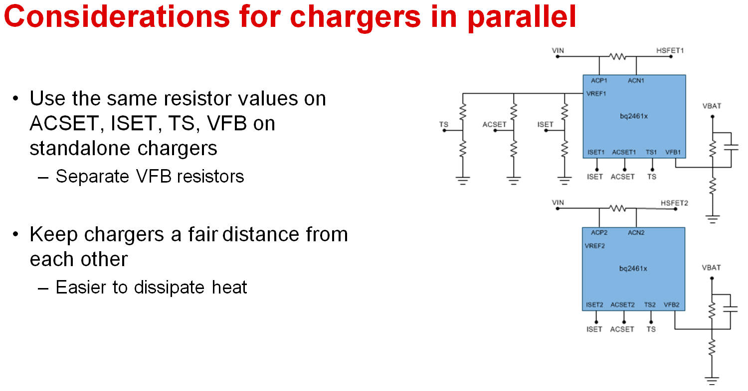

Dear Specialists,
My customer is interested in bq24617, and has a question.
Could you please advise?
---question1---
Is it possible to use charge current 14A?

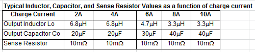

I think it's possible to use using appropriate FET if the device is able to drive FET.
Is it correct?
If so, could you please advise the value of inductance, output cap and sense resistor.
---question2---
Also, question about the bq246xx calculation Tool V1.5(Rev.D)
http://www.ti.com/product/BQ24610/toolssoftware
What should he do when charge current is 14A ?
I appreciate your great help in advance.
