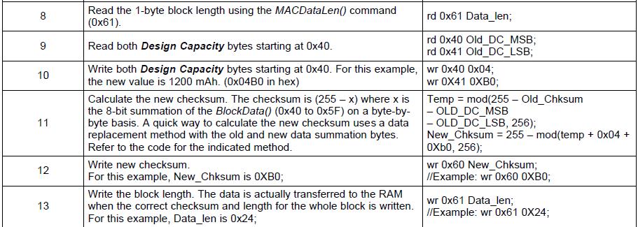

  • The data length contains the 2 bytes address (register 0x3E/0x3F) and the check-sum register (0x60) and length register (0x61). So the total is 36 bytes.
    Note that the example in 6.1, step 13 also shows a length of 0x24 = 36 bytes.
  • Does the check-sum include in its calculation 0x3e, 0x3f and 0x61?

  • The check sum is the 255 - the 8bit wide sum of the starting address and the block bytes.
    Example:
    W: AA 3E B4 91 FD 00 00 03 00 00 00 00 CB D4 1A 05 D4 86 4A C6 B4 C2 6E 2B 03 7C 01 48 FD A3 F6 75 12 58 2D B7
    W: AA 60 62 24
    Adding up B4 91 ... B7 equals 0D9D, so the check sum is 0xFF - 0x9D = 0x62

  • The gauge will auto increment its data pointer so you need to take this into consideration when reading the check sum.
    An easy method to update a specific parameter is this sequence:
    1. Enter CFG_UPDATE mode
    2. Write the address AND the parameter data to 0x3E+ (auto increment)
    3. Calculate the check sum: 0xFF - (sum of address and data) OR 0xFF
    4. Write the check sum to 0x60 and the total length of (address + parameter data + check sum + length) to 0x61
    5. Exite CFG_UPDATE mode
    Example: Set OT Chg Time to 8 seconds:
    OT Chg Time address = 0x9234
    Data = 0x08
    2. write 0x34 0x92 0x08 to registers starting at 0x3E
    3. check sum = 0xFF - (0x34 + 0x92 + 0x08) OR 0xFF = 0xFF - 0xCE = 0x31
    4. write 0x31 to 0x60 and 0x05 (=2 bytes address, 1 byte data, 1 byte check sum, 1 byte length) to 0x61

  • I am still receiving incorrect checksum results back from the BQ27220.
    1. When I send the command above (0x9234), the checksum results are always off, but by multiples of 0x10 and the results change on almost every time I run the test (see below).
    2. With the example in 6.1 of the user guide (0x929F), I still get a checksum error, but the results returned by the BQ27220 never change.
    3. Finally, I can write to the Operation Configuration A register (0x9206) and it always returns the correct checksum.

  • Please try my previous example step by step. I verified this on the EVM with bqStudio / advanced communication. Please try this first in bqStudio with advanced communication. Once you can successfully perform a parameter update, then translate this to code and debug this by analyzing any differences.
    There must be something obscured in your implementation that prevents the gauge from updating data and check-sums as expected.
  • I finally got it to work late last night, but with the following conditions:
    1. Data transfers MUST fill and transfer the whole MACData buffer (32 bytes) in a read-modify-write set of operations.  Partial transfers (like the example above with a length of 0x05) do not work.
        1a. Is it possible that bqStudio hides this step from you?
    2. I must subtract 0x20 from the final calculated checksum before putting the result in MACdataSum (0x60).
    Thanks, this issue can be closed now,
    ...kevin
  • That's very good news!!
    About 1a: I've been able to execute single parameter updates without bqStudio so I don't think that this is due to bqStudio.
    About 2: That's strange. I don't know why this would be required?
    .Dominik.
  • hi,
    Need some clarification:
    1. Can any expert confirm if the #1. Data transfers MUST fill and transfer the whole MACData buffer (32 bytes) in a read-modify-write set of operations.  Partial transfers (like the example above with a length of 0x05) do not work?
    2. If the answer in #1 is partial transfer can be done. Then the next question is
      In BQ27220 TRM Page 65/88 Application example, I need to update “Data_len” at step 13. How to calculate this “Data_len”? Is it the same value read at step 8 or we need to calculate it based on the intermediate steps 9 to 12? I don't see step 9 to 12 got alter the data_len value. does that means data_len is the same value read at step8 and step 13?
    best regards,
    kpk
