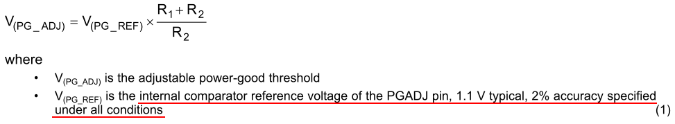

Q2: V(PGADJ_TH) accuracy
Datasheet 7 describe V(PGADJ_TH) is 1.067V(min), 1.1V(typ) and 1.133V(max) and it is 1.1V +/- 3%.
But datasheet page 13 describes as follows.
Please confirm that V(PGADJ_TH) accuracy is +/-3% or +/-2%.

    Q2: The correct tolerance is 2%
    Q3: Your equation #1 is correct for the falling threshold of PGADJ.  Hysteresis will cause PGADJ to trigger on the rising threshold approximately 2% HIGHER than the V(PGADJ_TH) specification (V(PGADJ_TH) = 1.067 (min), 1.163 (max)).
    In other words, V(PGADJ_TH) describes the threshold voltage when PGADJ voltage is falling.  The threshold voltage is approximately 2% higher when PGADJ is rising.

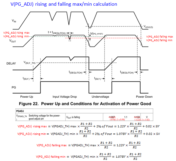

    Q1: V(PGADJ_TH)
    I asked about V(PGADJ_TH), but your answer is PG threshold (when PGADJ = GND) and I understand that I should use Vout=5V for the 5V device.
    Could you please answer original my question about V(PGADJ_TH)?
    Q2: V(PGADJ_TH) tolerance
    According to your answer that V(PGADJ_TH) tolerance is 2%.
    So could you please revise the datasheet as follows?
    Q3: V(PG_ADJ) rising and falling threshold calculation
    Q3-1:
    I may understand your advice.
    Could you please confirm if my understanding of how to calculate V(PG_ADJ) rising and falling threshold of attached file is correct?
     5023.TPS7B6850-Q1_V(PG_ADJ) rise and foll threshold.pptx
    Q3-2:
    Following explanation of datasheet contradicts with your answer.
    Could you advise if following modification is correct?
    Please revise datasheet if following is correct.
    Best Regards.

  • Hello Mike-san,
    Thank you for your answer.
    I will report your answer to customer today.
    Q3-1:
    Please answer if my calculation of following that I posted on Jul 3 2017 is correct or not.

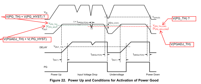

    Q5: (additional question)
    For figure 22, V(PGADJ_TH) rising and falling threshold is as follows according your answer.
    How is V(PG_TH) rising and falling?
    Is following my understanding correct? If it is correct, could you modify the datasheet like following? I think it easy to understand the rising and falling threshold voltage of V(PG_TH) and V(PGADJ_TH)..
    Best Regards.

  • Hi Ushikubo-san,
    I'm very sorry, I checked further database parameters, and the information I gave previously in this post is not correct. The spec. VPG_ADJ is indeed 3%.  So, the data sheet values listed in the EC table is correct.
    The rising threshold is typically 26 mV higher than the falling threshold typical value (1.1 V).  So, rising threshold will be V(PGADJ_TH) + 26 mV.
    I'm sorry for the confusion.
    Mike
  • Ushikubo-san,
    In addition to my post above and to answer Q3-1, the threshold value to use for the rising power good is not specified under min. and max conditions, because the hysteresis is not specified. However, the variation is small and the min. and max. can be very closely approximated as below.
    VPGADJ_TH RISING.
    1.067 + 26 mV (approximate min.)
    1.133 + 26 mV (approximate max.)
    The falling threshold values are as specified in the data sheet, so,
    VPGADJ_FALLING
    1.067 (min) and 1.133 (max).
    To answer Q5, VPG is specified at the RISING edge (as opposed to the FALLING edge, for VPGADJ_TH), then the hysteresis is 2% lower than the rising edge.
    So, VPG_TH RISING
    89.6% VOUT (min)
    93.6% VOUT (max)
    VPG_TH FALLING
    89.6% - 2% (approximate min.)
    93.6% - 2% (approximate max.)
    Your drawing is correct. I agree that the graph is not clear because the variable names to do not match the EC table variable names. We will submit these data sheet clarifications into the data sheet process flow.
    I hope this clarifies the questions.
    Mike
