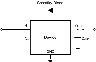

    Would you be able to give us more information about your application? What is the regulated output voltage? If the input supply is dropping below the regulated output voltage the part can experience reverse current, which has the potential to cause damage to the LDO.

  • Hi Matt,
    When you are power cycling are you letting the input and output go all the way to 0V? If you have a large reverse current there is a potential for latch-up to occur and if the part is powered back up before the latch-up is removed it can cause some problems.
    You may want to try to put a fixed load resistor on the output or place a schottky diode from in to out as shown below.
    Mark
  • Is the Schottky diode needed, if the p channel fet used in the device has its' body diode connected from out to in? In the same orientation as shown above.
  • Hi Matt,
    That diode that is there is not a protective diode it is a parasitic diode. The schottky diode will have a lower forward voltage than the body diode, which it will keep the reverse current going through the part causing damage.
