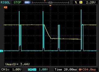

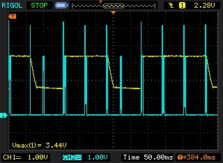

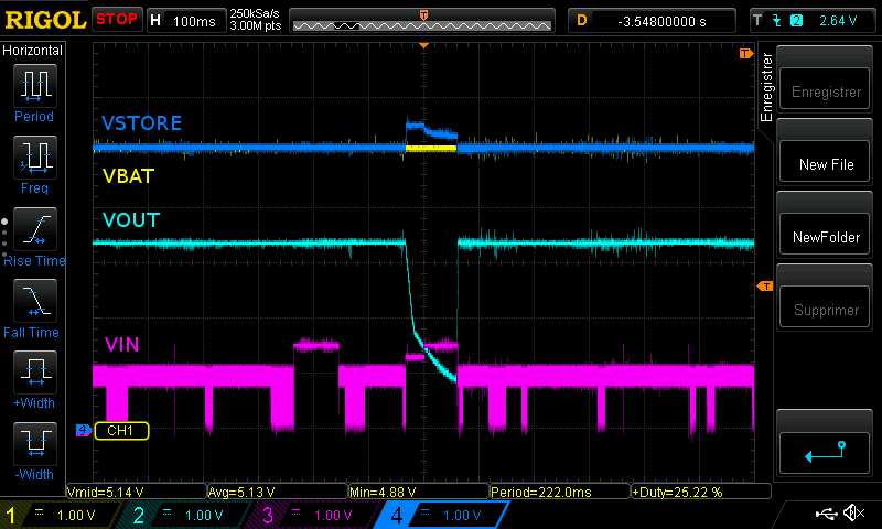

I'm facing an issue with my bq25570 and i don't know why. We've made a first board able to recharge supercapacitors (two capacitors of 0.75F, 2.7V in series) with a VBAT_OV configured at 4.16V and a solar panel of 0.5W in input. All is working fine with this board.
But we have made a second board with a VBAT_OV configured at 5.04V and two supercapacitors of 35F, 2.7V and the same solar pannel in input. But when VBAT reaches 5.04V (even before but i'm not sure), sometime VOUT falls down that makes my MCU to be reset (as soon as i unplug the solar panel, it stabilizided again a little bit).
if you have any ideas or suggestions please feel free to reply. I'm not an electronician, i'll try to do my best to answer. Here is the shematic :
