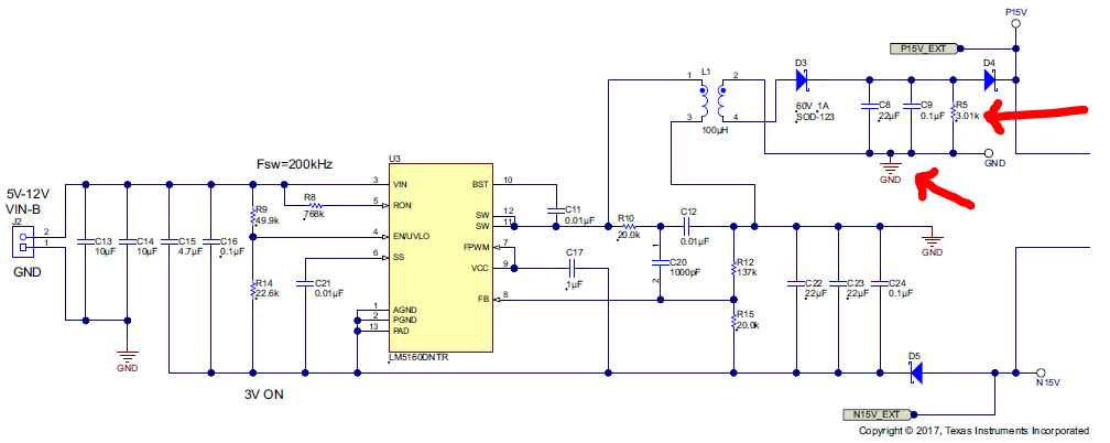

now I want to convert +5V to +6.7/-6.7 like the document in the below :)
look at page 3 and 16:
http://www.ti.com/lit/ug/tidud38/tidud38.pdf
look at page 17:
http://www.ti.com/lit/gpn/lm5160
as per equation (7):
  • now the above frequency in "tidud38.pdf"  is negative!!! bcoz  Vin_min=5V and Vout=15V :)
  • on the other hand, how did they use TPA7A47 as 15V to 5V converter?! even with TI webench is not possible :)
  • How did they use LM5160 as a step-up converter?

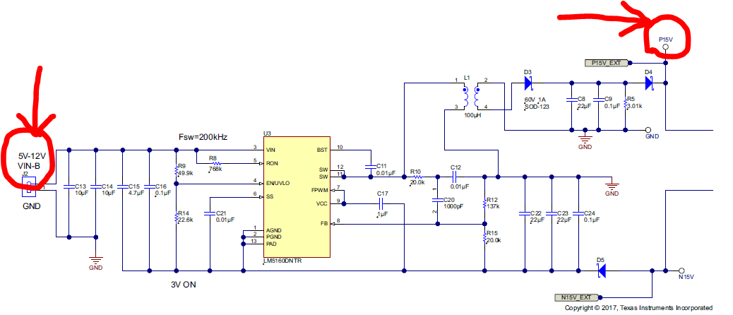

    what happened in "tidud38.pdf"? I want to have +/- 6.7V from +5V like their design.
    It's probably they used buck-boost technique.
    thanks
  • Hi xyzxyz,
    The schematic above shows a Fly-Buck-Booost configuration. Note that the primary-side output is -15V. The relevant duty cycle expression is that for buck-boost conversion.
    Tim

  • I found a useful link:
    https://www.pddnet.com/article/2015/03/inverting-fly-buck-design-simplifies-bipolar-rail-generation

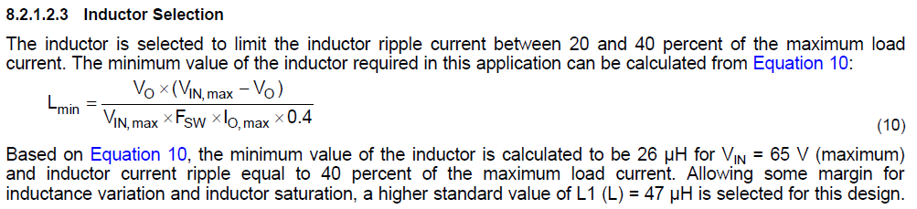

    how should I select Lmin (minimum value of inductor)?
    in the LM5160's datasheet there is a formula:
    but I think it's not true for this application bcoz I calculated above equation for "tidud38.pdf" and the value is 2.4mH not 100uH.
    on the other side there is a resistor at output of Vout2 and both grounds are connected to each other :
    thanks

    do you know how I should select the minimum value of inductor in the flybuck-boost converter?
    as per equation (10) above Lmin to be approximately 2.2mH (I used abs value)
    but I think it's not true bcoz in the document above, L is 100uH.
    I think Lmin=abs(vo1)/vi_max/Fsw/Iout/0.4=93.45uH (it's only a guess)

    As long as the peak current in the inductor is less than the minimum peak current limit of the LM5160 [2.125A], then you can use the inductance value in your desgin.  Also make sure that the transformer you use does not saturate at the max peak current limit level of 2.875A.  See the equations for flybuck boost attachedFlybuck Boost eqs.pptx
    Hope this helps?

    1-I calculated the Lmin in other TI's flybuck-boost circuit using the equation I guessed above. the results are very close to each other. I think the
    L= abs(vo1)/vi_max/Fsw/Iout/0.4
    not
    e2e.ti.com/.../ind.PNG
    I think the equation above is true for a standard flybuck.
    actually when we read an article we pay attention to the total framework but in the later when we want to design a circuit we will understand the author didn't mention some key-role formulas in his article :)

    3-why did they put a 3K resistor at the output of isolated output?

    The 3.3k Resistor is a preload resistor. It is placed there to ensure that when the isolated rail is unloaded, the voltage on the isolated output does not peak charge the output cap way above the specified output. The preload helps hold down the voltage in the event that the isolated rail becomes unloaded.
    The Fly buck boost Duty cycle recommendations is 50%, from your specification you will be a bit higher than this. This should be ok as is is not too far away from the 50% recommendations.

    I used all the formulas but there is no formula to select the inductor value.
    I checked the formula that I guessed above. it works in all TI's circuits (only for flybuck-boost)

    I have gone through the math and you will not be able to get +/-6.7V out with 0.5A on each rail without the LM5160 hitting Current limit[from 5V in].
    I have calculated you will be able to deliver slightly less than this.
    With that said, try a coupled inductor with an L Primary of 22uH with a turns ratio of 1:1:1 for a low peak to peak ripple current in order to maximize the amount of current delivered at the outputs without hitting ilimit. The Isat on the coupled inductor needs to be greater than 2.875A.
    In Summary  suggest trying the following.
    Fsw = 500kHz.
    Lpri = 22uH
    Turns Ratio = 1:1:1
    Isat = 2.875A
    Hope this helps?
