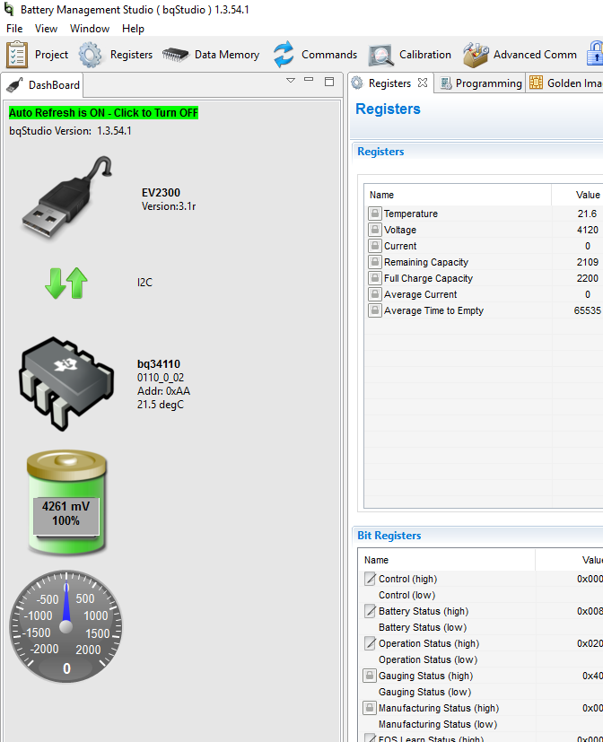

  • Onyx,
    I've tried with both firmware version 3.1m and 3.1r for the ev2300 and when I generate the dffs file I've these first lines :
    ;Verify Existing Firmware Version
    W: AA 3E 02 00
    C: AA 3E 02 00 FF A5 FF A5
    which is not good.
    When I try to program the device it told me : parse error at line 5.
    I can try to disable these lines but I fear that data may be corrupted at other places...
    Do you have suggestions?
    Here is a screenshot:
    Thank you,
    Michael

  • Hi Michael
    Was the gauge automatically detected when you started bqstudio or did you select the gauge from a list? Can you attached your dffs file so i take a look? Can you program the default firmware www.ti.com/.../sluc622 without any changes to it and then extract a flash stream and then try programming that on your unit?
    thanks
    Onyx
  • Hi Onyx,
    I manually corrected some lines in the generated file and been able to program the gauge.
    I will do some tests and get back to you.
    Thank you
