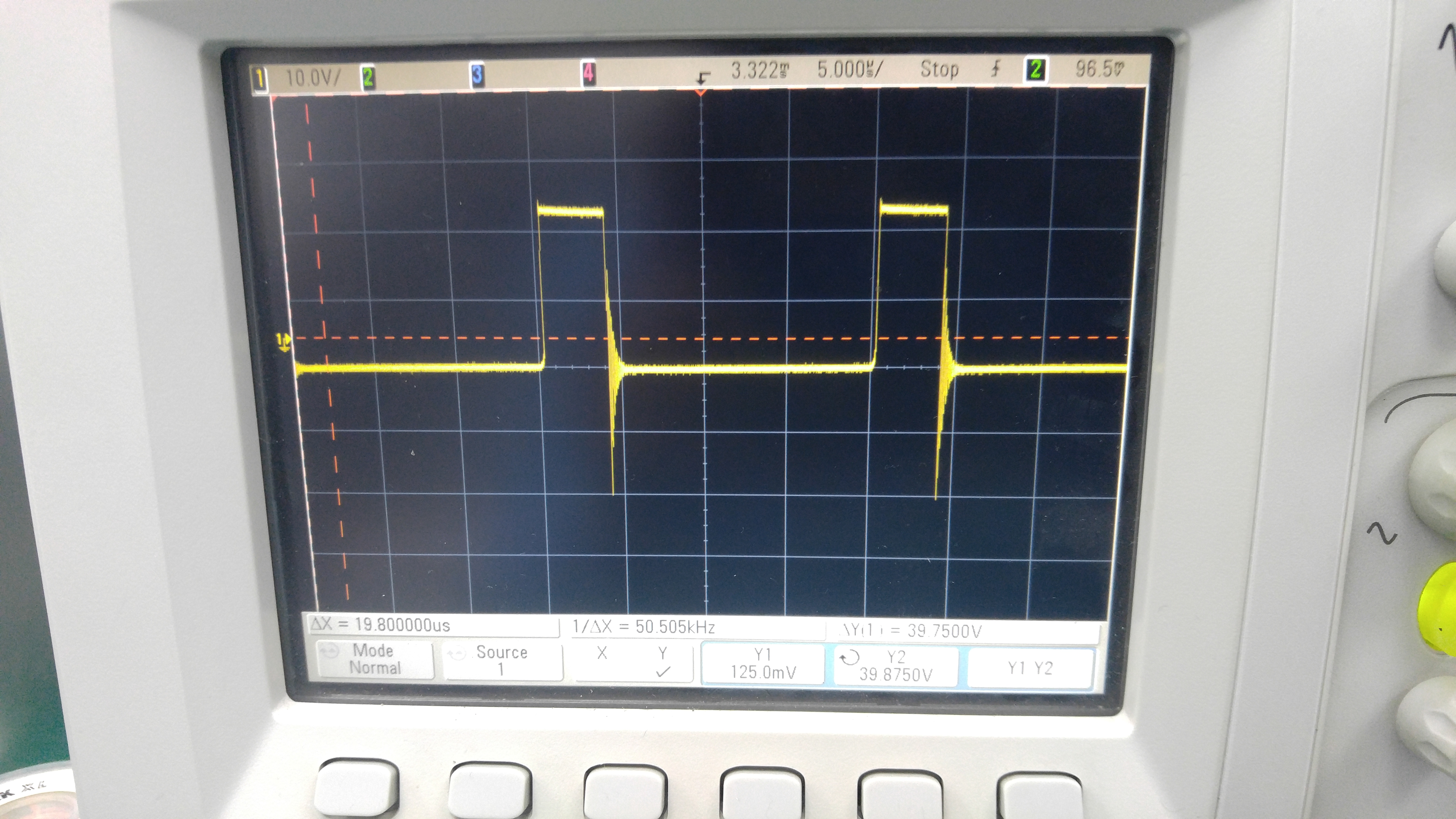

the current flyback design used LM2577 to boost +5V input to +15V (75mA) & -15V(110mA).
We using Cout - 330uF,50V
Cc - 330nF, 50V, X7R, 20%, 1812 package
Rc - 3.01K,1% 0805 package
It runs at 50KHz freq. Ripple measure @ load - 200mV P-P

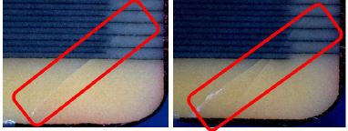

We are facing 2% of compensation capacitor failure during functional test. i.e- Capacitance dielectric fails and IR measure in Ohms instead of Mohms.
Can you please comment what can cause compensation cap failure ?
    Can you show me the layout and schematic?
    And also please show the waveform on Comp pin and Vo.

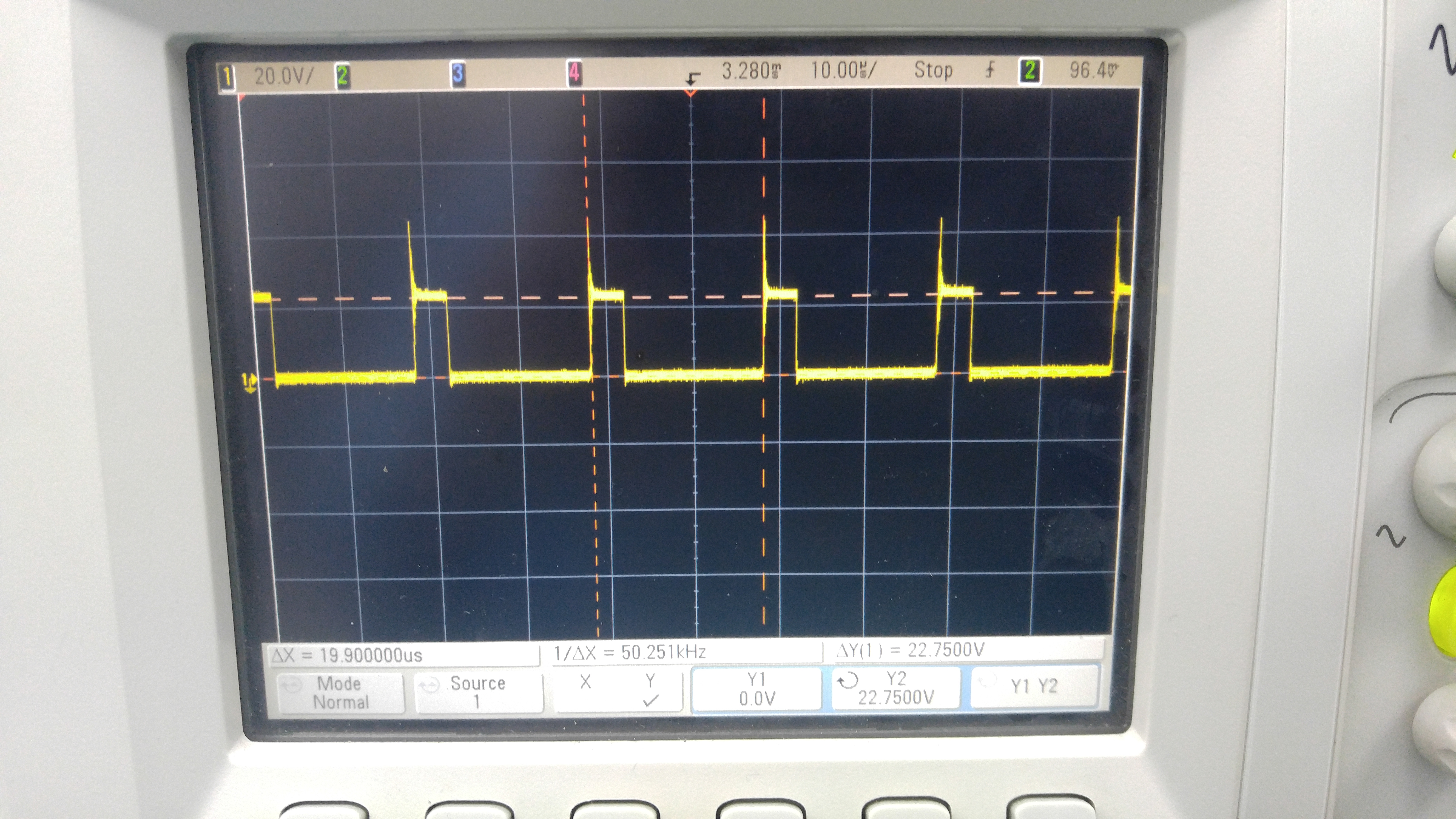

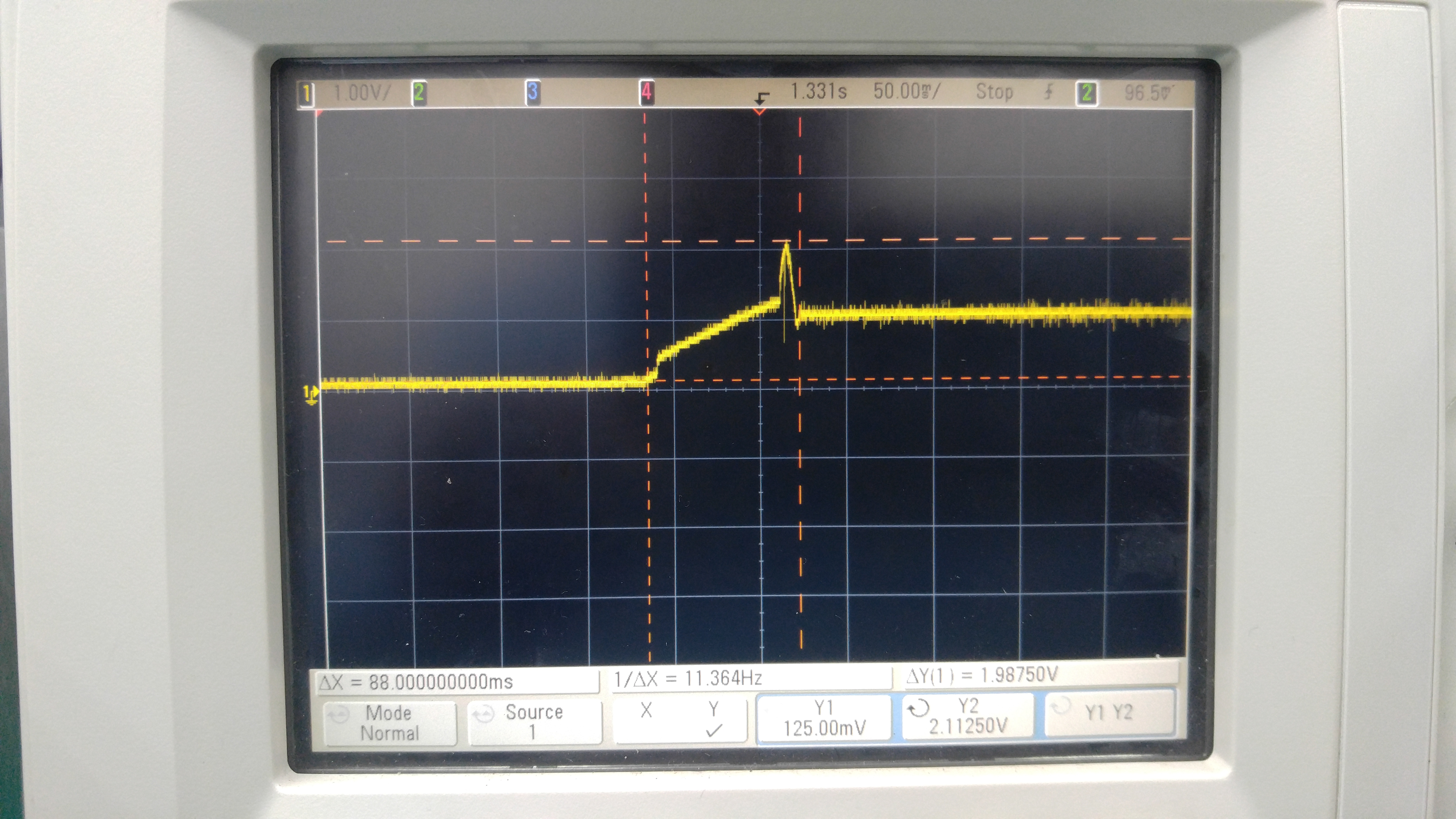

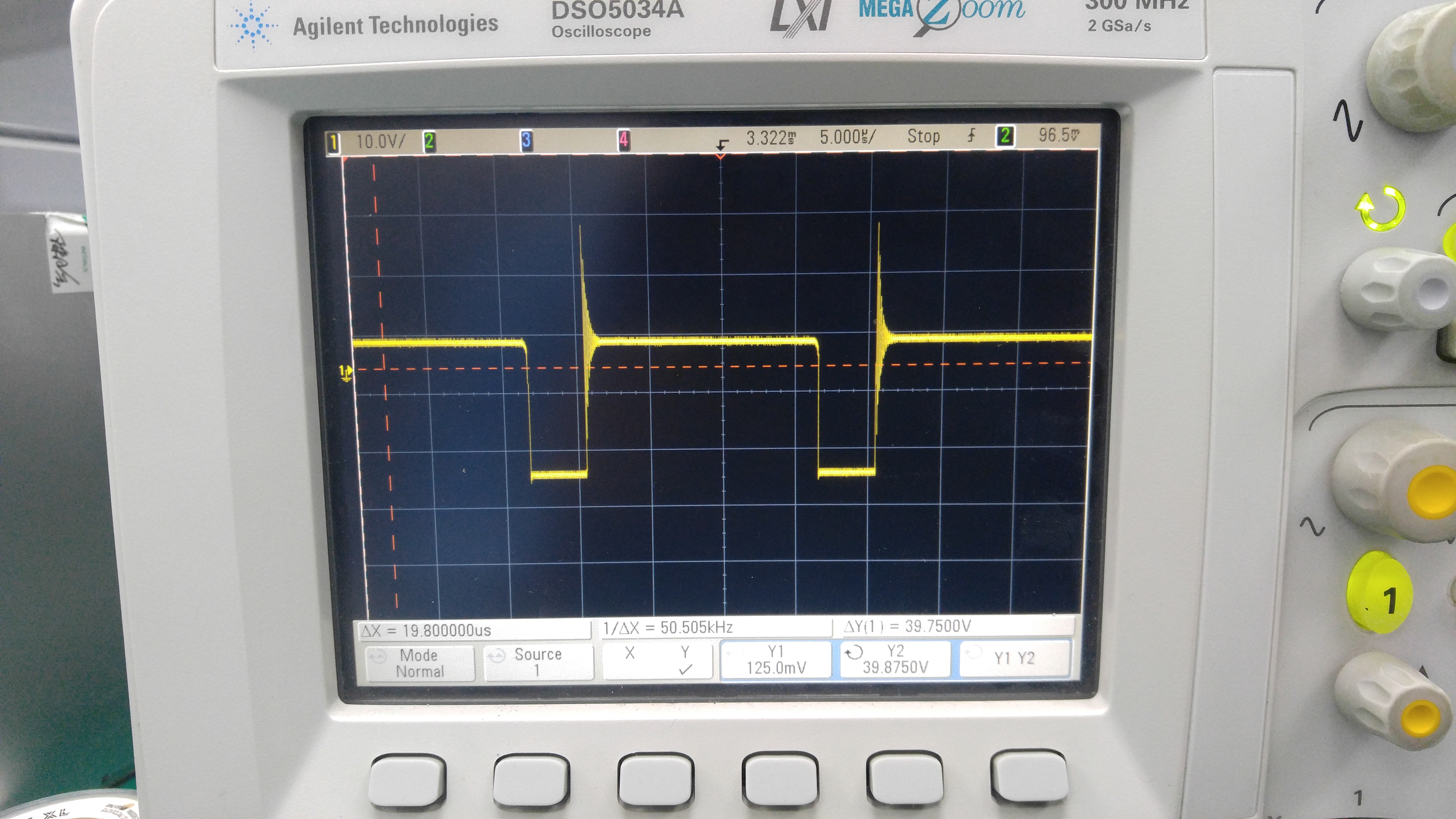

  • Hi Natarajan,
    Can you give me the zoomed waveform because I cannot see clearly from the work document.
    And have you ever tried to replace new capacitor to the failure board? Did the chip also stop working after changing new capacitor?
    Form the layout in the document, it seems that the layout is not so good. Keep SW pins close to transform to decrease the leakage inductance so that the spikes on SW will much smaller.

  • Hi Zack,
    sorry for late reply.
    Waveforms attached for your reference. Yes, after we replace new capacitor, our PCBA start functioning. what we observed is microcrack in the capacitor after the functional failure ( during fuctional its failing ). will the capacitor generate microcrack due to spikes on SW ? OR anyother electrical parameter cause this microcrack ?

  • Hi Natarajan,
    According to your reply, I think the microcrack on this capacitor is due to the mechanical stress. If the capacitor fails because of the high voltage, the chip will not work after changing a new capacitor.
    I suggest you have a new layout because now the transformer is far away from the chip. The high leakage inductance will cause high spike on SW pins and also cause high temperature rising on transformer and the chip. The high temperature will let the board have deformation.
    You can also have a try to use other kinds of capacitor.

  • Hi Natarajan,
    Usually the microcrack on capacitor is caused by mechanical stress. Failure of ceramic capacitors due to PCB flexure is a common problem.
