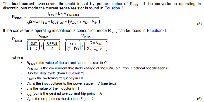

If I am using the TPS40210-Q1 as a SEPIC instead of boost, do the following equations still apply in the same manner?
Thank you in advance,

Hi Jared,
Since the topology is a SEPIC the equations will change slightly. In a SEPIC the switch will see the output current as well as the input current. This means that the peak current during CCM operation will be equal to the input current plus the output current plus the inductor ripple current. Please see the attached document for equations.
