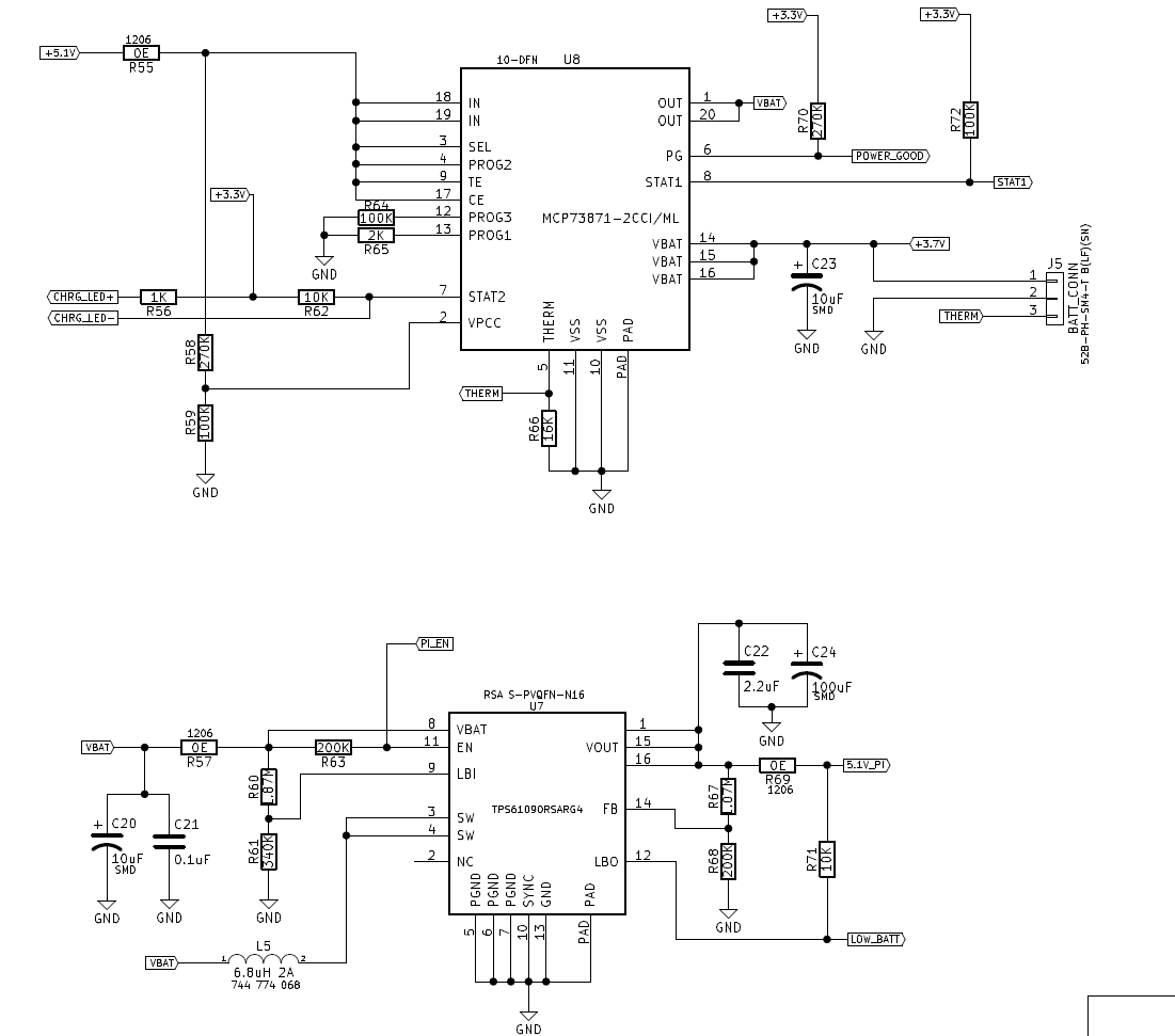

Hello TI,
Brief description:
Our circuit contains 5V input adapter source given to MCP73871 (U8) charger IC with 3.7V Lithium Ion battery for backup. So during power fails battery takes in charge. This output is given to TPS61090RSARG4 (U7) IC which then boost the voltage to 5V and max load is only 500mA. I've attached our circuit diagram below including gerber view and placements. We have used these components for the first time in our designs and hoping to use it in future a lot.
Test Setup:
1. CRO Probe connected to TPS61090 VOUT at R69
2. Input voltage 5V Bench Supply given at R55 ( Not SMPS based) excluding rest of circuit with no LOAD's connected. (Input will be 7V 3A SMPS adapter in actual application)
3. Battery Not connected to charger circuit. (When battery is not connected the Input voltage at R55 is given as VBAT)
4. R67 = 1.8MOhms, R68= 200kOhms. (on CRO here it shows 0.540mV) (Correction done on Resistor divider)
5. The dot on 6.8uH power inductor is connected to VBAT,
6. PI_EN Pin is open in the circuit and going only to external connector.
Problem:

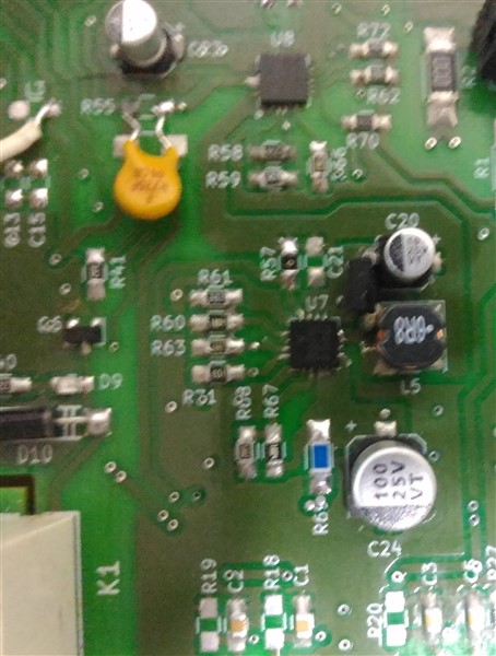

1. Circuit works fine for some time. Gives 5V output perfectly with no Load. After some time or sometimes immediately the TPS61090 IC gets short circuited pulling lot of current through Charger IC disabling output of Charger IC itself. So we put a 500mA PTC fuse which also doesn't help and still destroys the TPS61090 IC. CRO just shows low voltage at the output side and no way to debug what just happened.
2. We have also noticed after removing the IC, pins 3,4 which is SW is getting shorted to PGND pins.
SCHEMATIC:

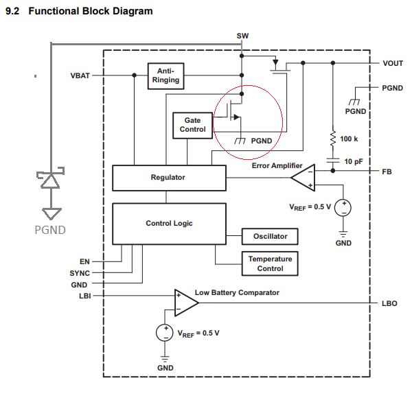

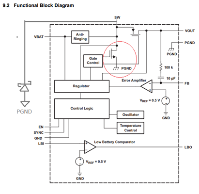

I have gone though some forum articles and found a similar issue on this post
https://e2e.ti.com/support/power_management/non-isolated_dcdc/f/196/t/435455
So we tried putting a Schottky diode of 100V rating which we had in stock to see if there was any protection needed for the FET on the gate control. So we kept it as close as to the SW pin. Which can be noticed on above picture of PCB view.
Then after connecting Schottky diode on SW pins 3,4. We turned on the Power supply and got 5V output very stable. But the below some drops in voltages were noticed. We think that these were creating problem and destroying the SW pin. Output voltage totally drops to 0V at some time intervals and some are steady.
The article in previous link also mentioned to use RC snubber circuit across SW pins to PGND which we have not tried yet. The critical 2.2uF capacitor is right below C24 highlighted in Green in Gerber View.

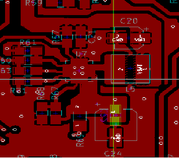

  • the location and routing of C22 is not good, which could cause high voltage spike in SW and damage the IC.
    You can refer to this application note www.ti.com/.../slva773.pdf to revise the layout.
    in current board, you can try to add RC snubber, the location of the snubber is also important, which can also be found the this application note

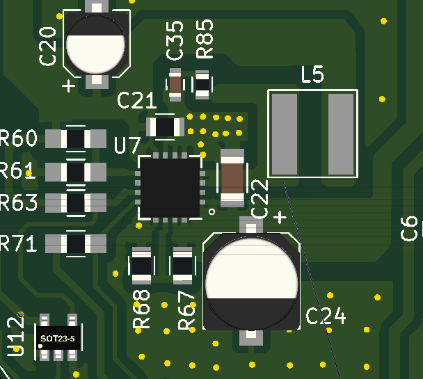

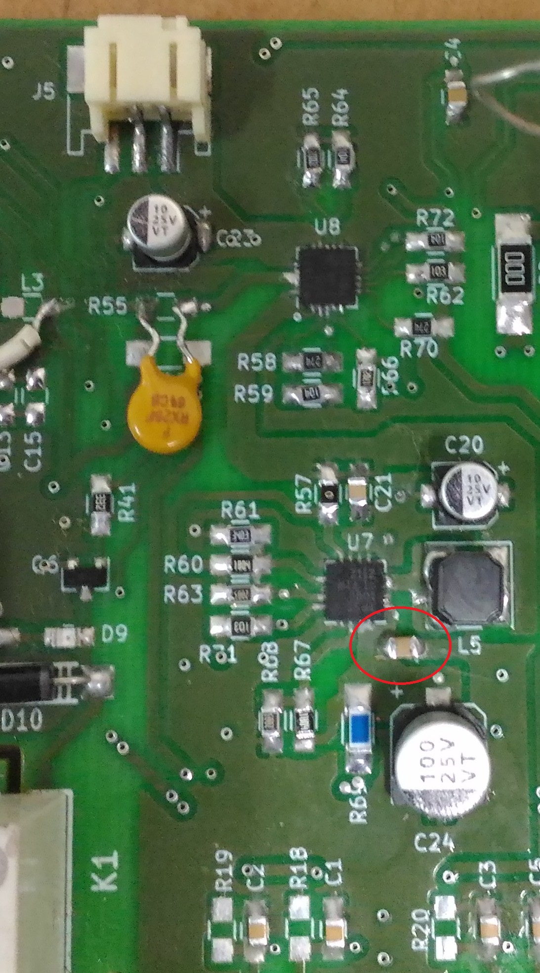

    Since there was no time manufacturing another board and reply you as soon as possible; we did some work around.
    Work Around:
    We had no time testing this out on a new board since manufacturing one takes time but we managed to put a 2.2uF (C22) as close as possible marked in red on the same old board. You can check the pic.
    There was still no improvement in the system. We destroyed another IC.

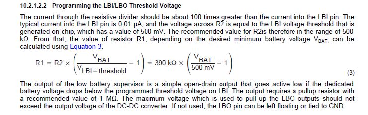

    New problem: (on working board with above specifications)
    We wanted battery low indicator at around 3V so we calculated Resistor divider circuit for 3V at LBI Pin.
    According to datasheet:
    We have chosen R2 = 340K. Hence for 3V threshold which gives R1 = 1.7MOhms. The closest we had was 1.87Mohms.
    So when 1.87Mohms is put, the threshold changes to 3.25V. (1.87M ,340k voltage divider circuit).
    After placing the components as per above calculations on the proper working board, we got 2.75V as threshold. (LBO pin was turning off at 2.75V and not at 3.25V).
    Work Around:
    https://e2e.ti.com/resized-image/__size/1230x500/__key/communityserver-components-multipleuploadfilemanager/f588cf25_2D00_f67f_2D00_4f13_2D00_b6fa_2D00_ff609a1d4ec0-133348-complete/P_5F00_20171124_5F00_104600.jpg
    https://e2e.ti.com/resized-image/__size/1230x300/__key/communityserver-components-multipleuploadfilemanager/f354adf5_2D00_f854_2D00_45bd_2D00_be3f_2D00_17ccf418c8b8-133348-complete/Untitled.png

  • from your figure, the location is closed to the IC. however, the routing between the capacitor GND PIN to the IC GND is too long.
    about the LBI problem, could you measure the voltage at LBI pin when the battery voltage is 3V to check if the voltage in LBI is correct

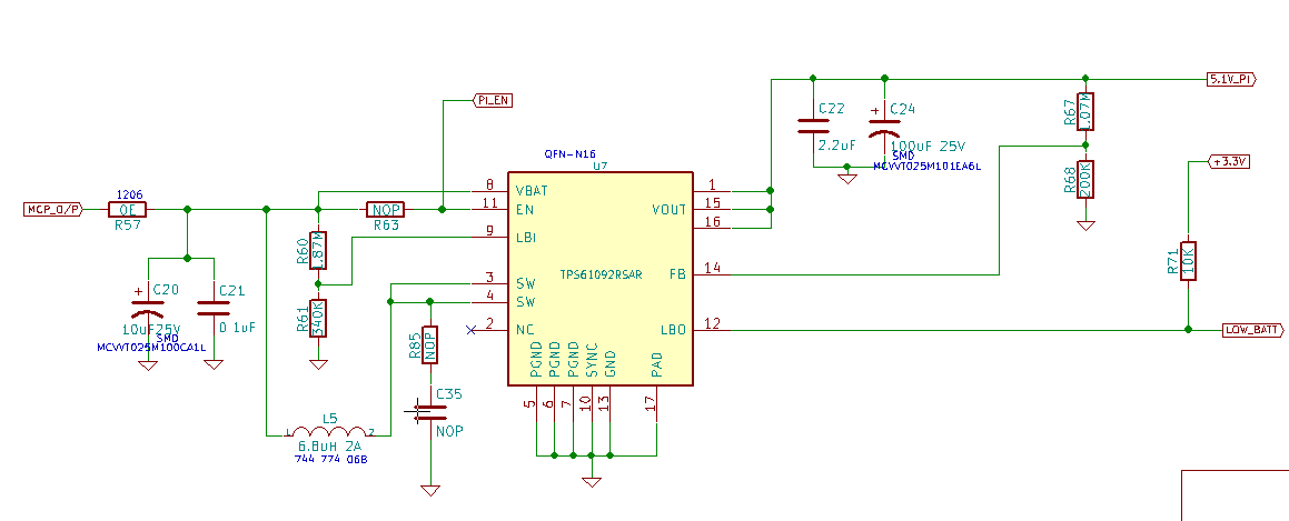

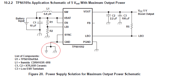

    On the datasheet there was a problem understanding the ground syntax used. Why there are two types of Ground symbols in this schematic? Is it something to do with plane separation or to isolate other grounds and get it to one single point so the return path is through this IC only?
  • you can send me the schematic and PCB layout image one this post as you sent before. i'll review them for you.
    they the signal GND and power GND. They should be connected in a signal point in the PCB.

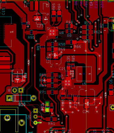

  • Jasper,

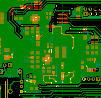

    below are new schematic changes. We only changed r63 to nop so we will enable boost using buffer gate at PI_EN.
    Below contains details of pcb layout. Please we need your help to review it.
    PCB top layer
    Bottom layer

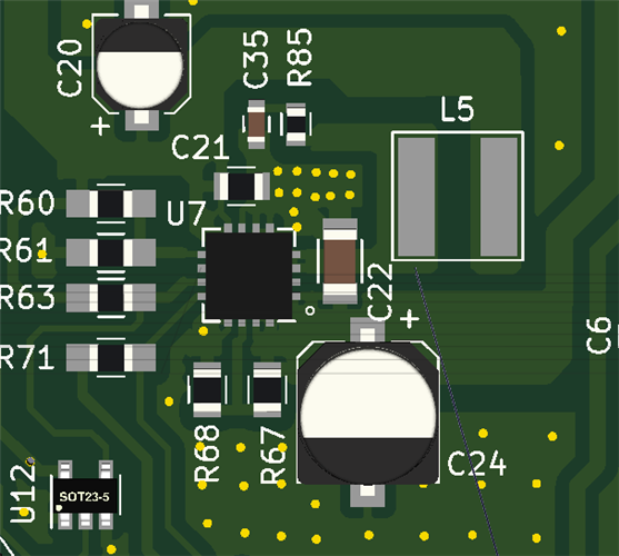

  • please rotate the C22 and place it closed the IC. place several via beside the GND node of the C22.
    the RC can be used if you can observe voltage spike in SW pin

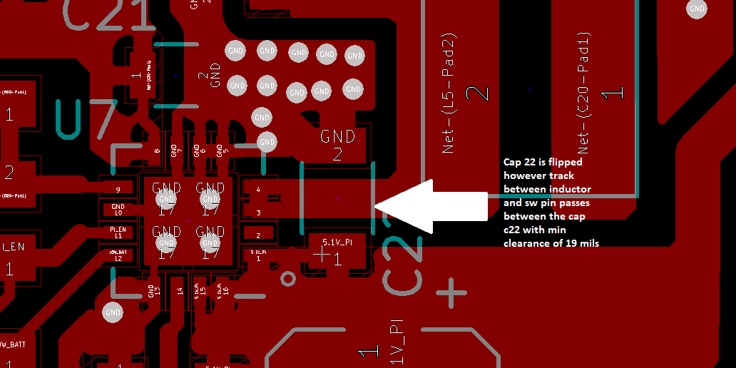

  • Jasper,
    We have done the changes, attached images below contains 3D view and pcb layout view.
    New changes include:
    C22 capacitor is rotated and placed close to IC.
    Lot of vias to PGND.
    SW Pin track to inductor is passing through C22 with 19mils clearance. Will there be any issue here?

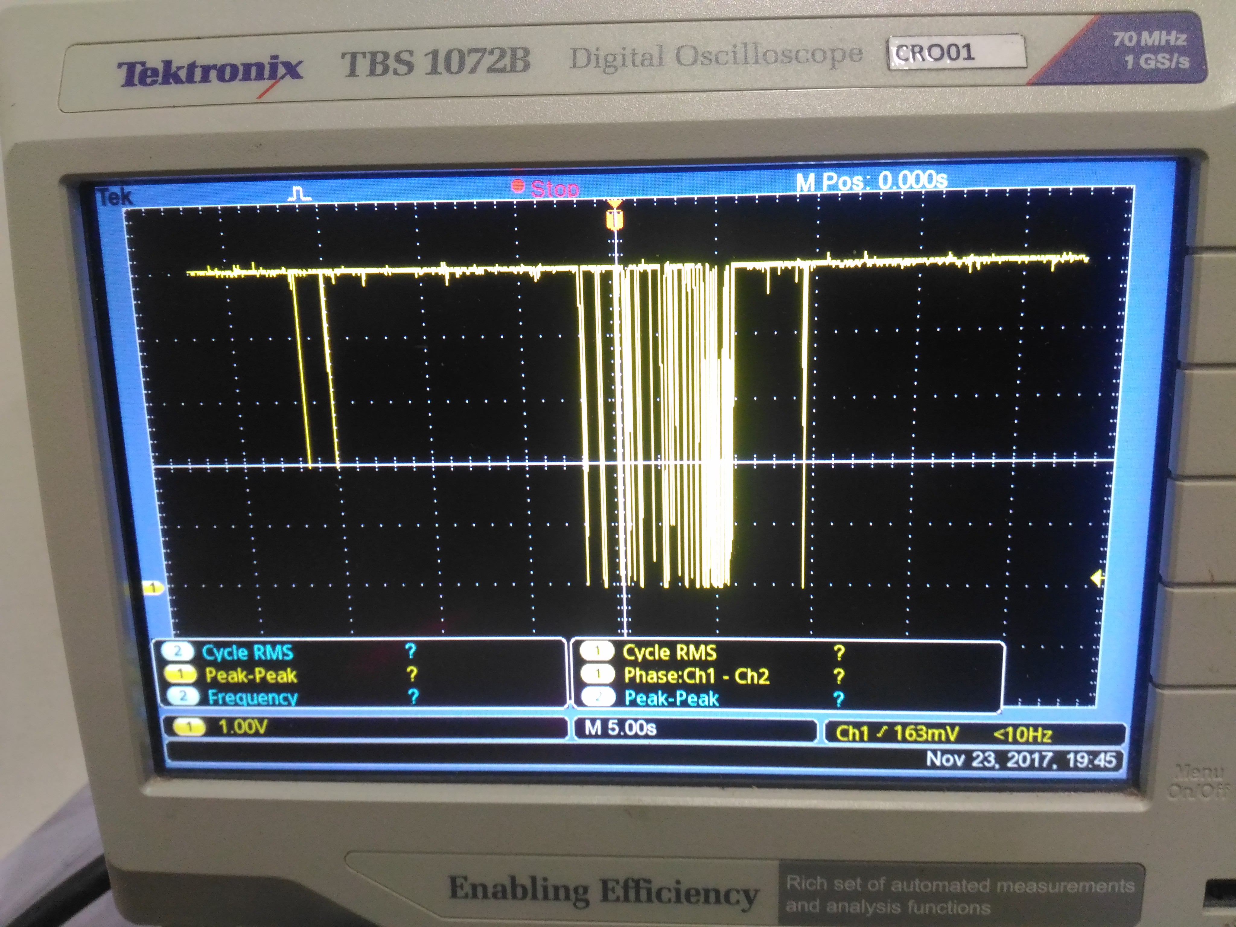

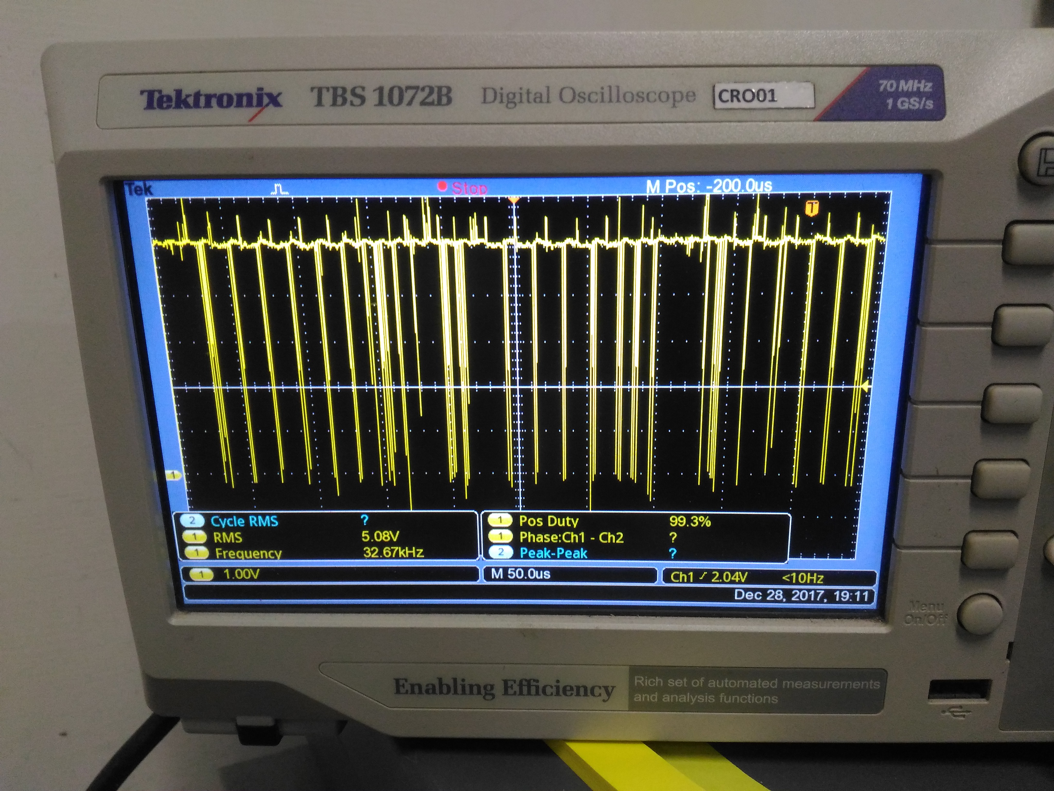

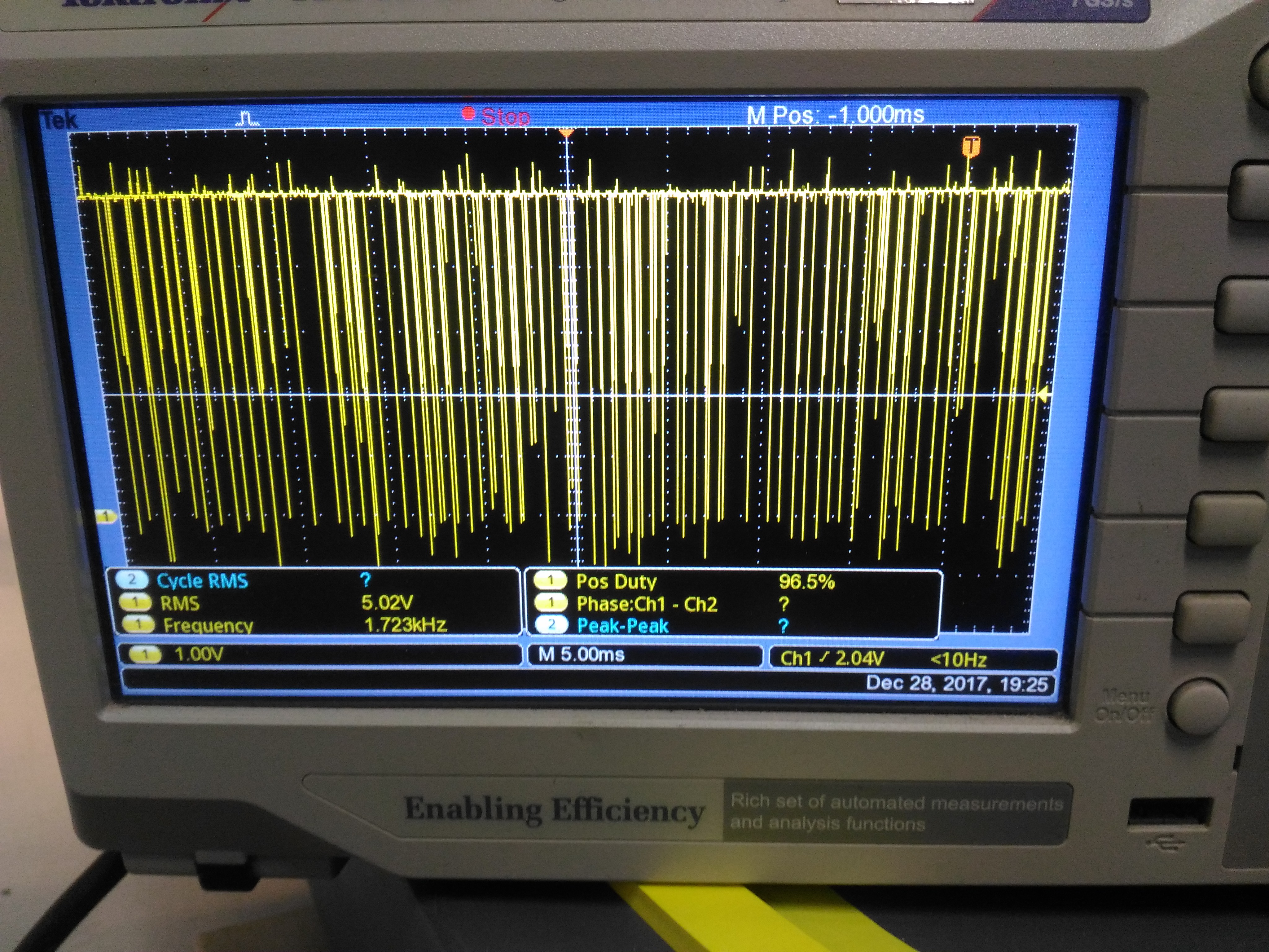

  • Jasper,

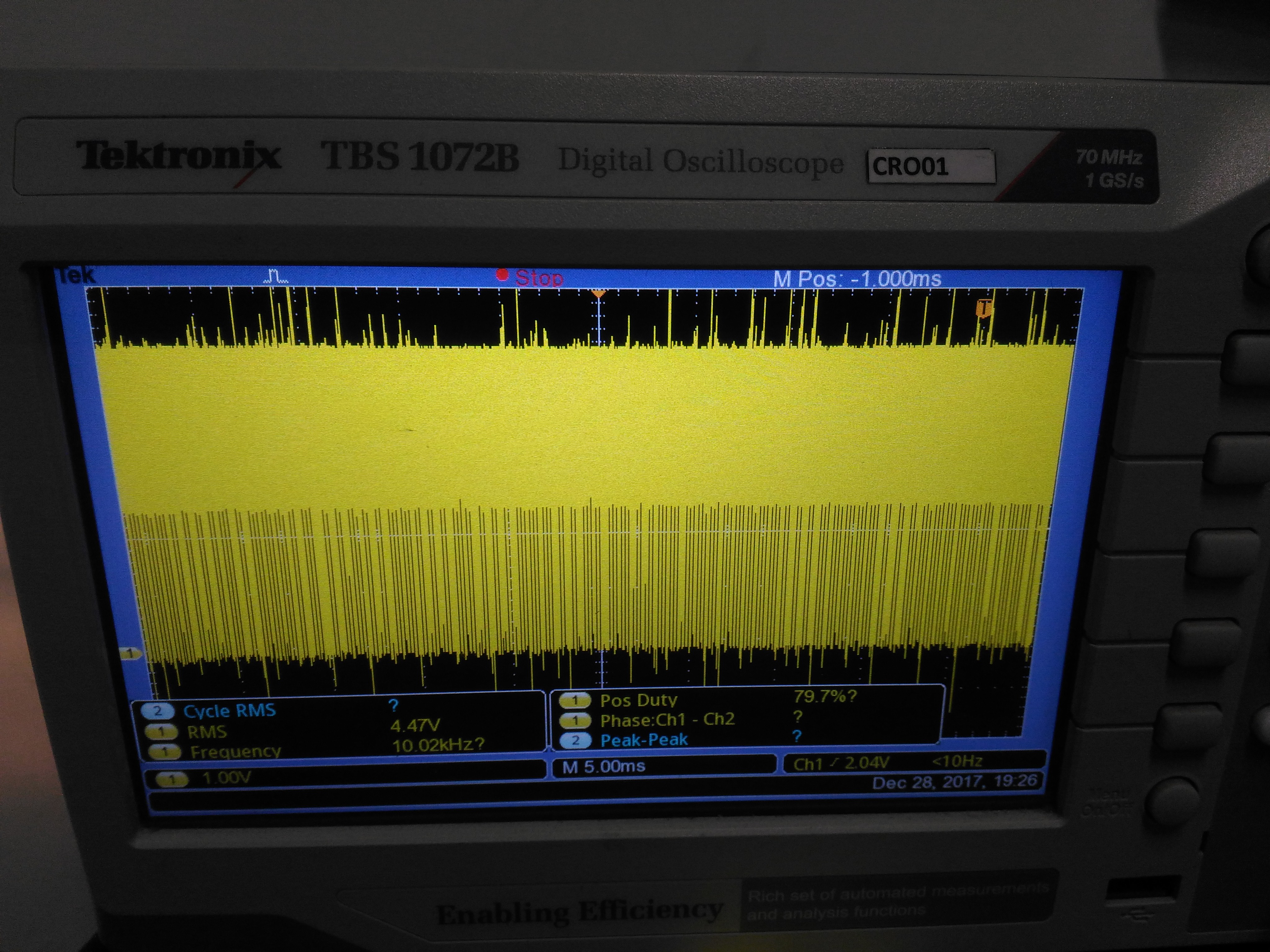

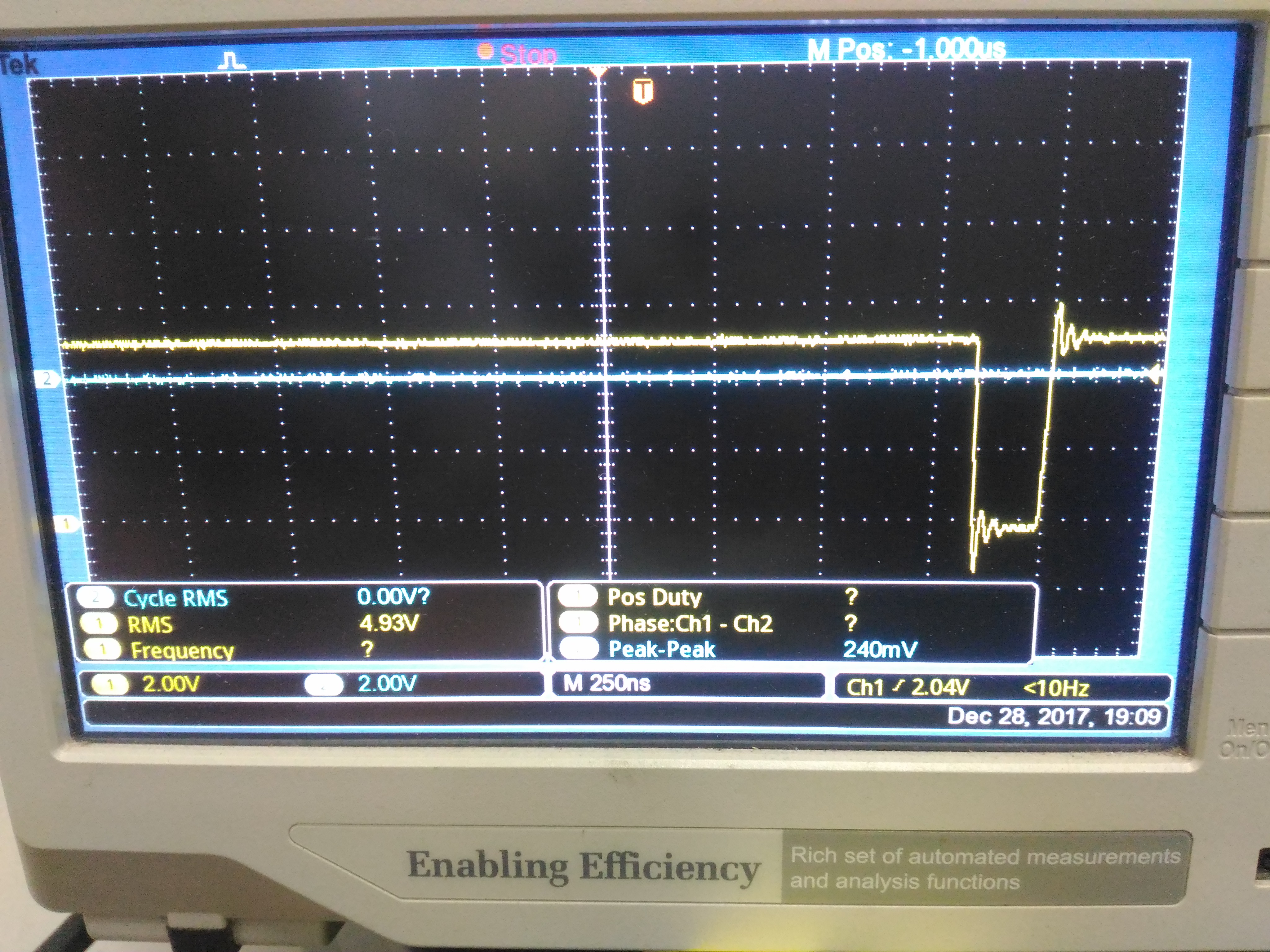

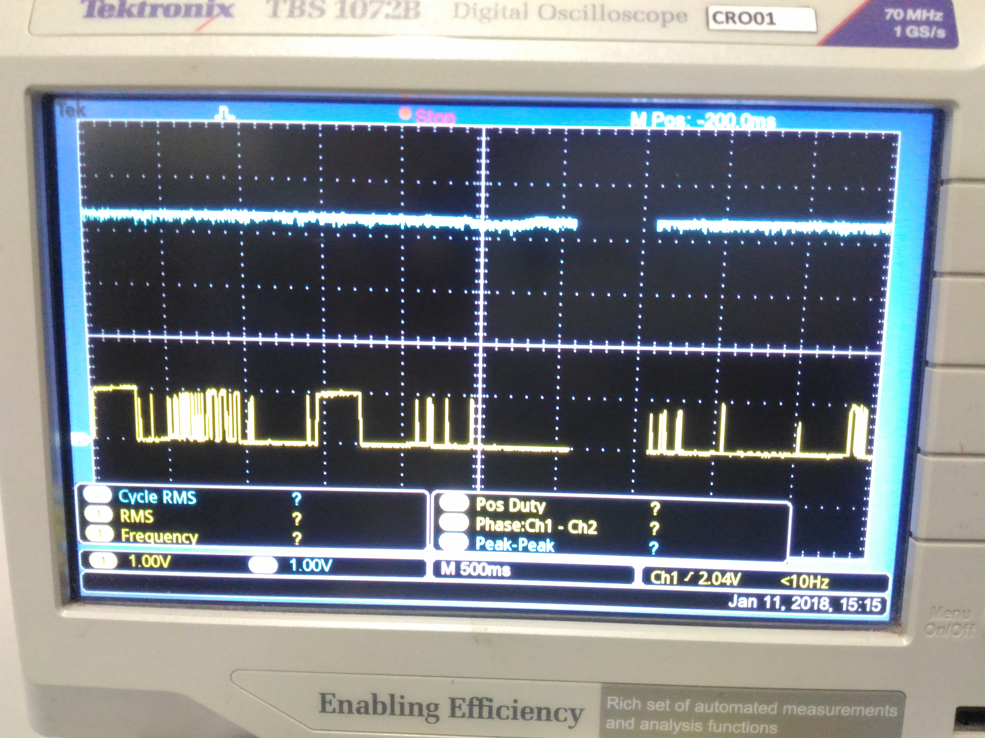

    We have populated the new board with TPS61092 IC . We have taken some screenshots of the CRO at SWpin.
    Kindly note the behavior in below photos of SWpin and let us know the feedback if this is normal or snubber circuit is needed.
    1.Pulse behavior on No load condition. (Very less switching is noticed)
    2: We connected 56Ohms load. (Behavior noticed on SWpin)
    3. We connected our main application raspberry pi and here are switching pin output below:
    4: When we reduced input voltage to 3.7V at TPS61092 input we got below results at swpin: (very high switching was noticed)
    Macjan
  • the waveform look OK.
    to check if need snubber, please zoom in the SW waveform at maximum load condition to check the voltage spike. you can add snubber if the voltage spke is higher than 9V.
