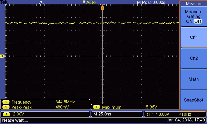

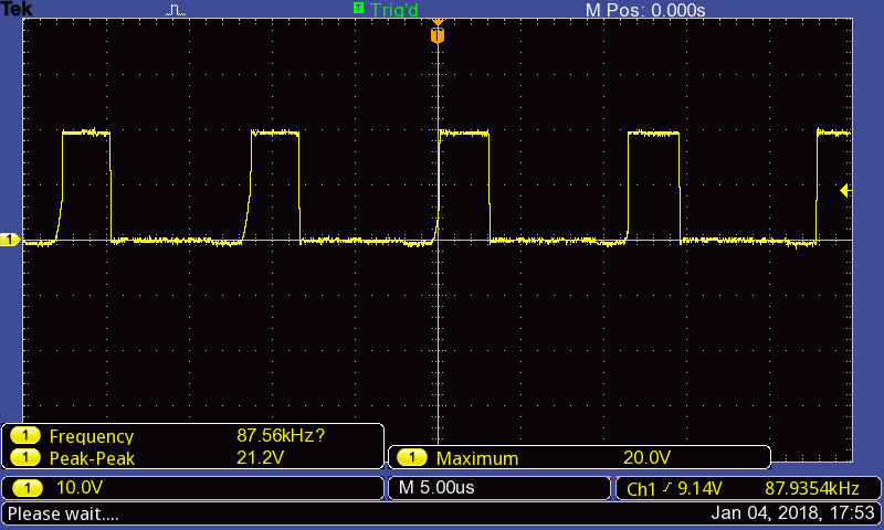

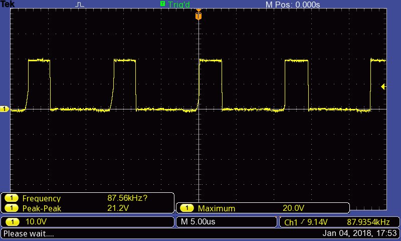

Hello Vishnu,
Based on the waveform you provided we don't see any instabiltiy. The humming could be a result of a poor inductor/ouptut cap. Just to confirm our theory that it is not IC related, can you provide me the following:
1) SW node waveform in a 1ms timescale
2) Inductor current in a 5us timescale
3) AC-coupled Vout (only ripple at Vout- not the DC value)
thanks,
Gautam
Hello Vishnu,
Were you able to collect the waveforms? It is common to have such a problem when the device is in critical conduction mode. Every 3rd or 4th pulse may ring due to zero current and this frequency (Every 3rd/4th pulse) is in the audible range.
Gautam
