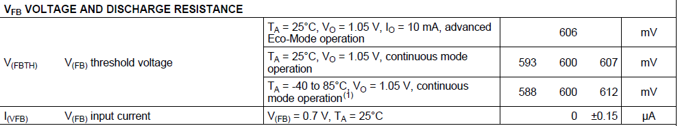

They confirmed that VFB and output voltage are output higher than D/S specification and design value with multi-tester.
(It is out of VFB specification range .)
・VFBD/S specification: min 593mV , typ 600mV , max 607mV(@output 1.05V).
 -> Measurement value is 0,6073mV with multi-tester.
・Output:3.387Vdesign value. -> Measurement value is 3.445V with multi-tester.

  • 1. You can use probe to measure Vfb.
    2. Different condition has different ref value.
    3. The spec written is our datasheet fixes on Vo=1.05V. For different output, ref has different threshold.

    1. Customer must use the IC PIN9 as the GND to measure VFB voltage no matter with Multi-tester or probe. There may be voltage drop between different gnd
    2. 607mV max is the 25C data, at 2A conditon, IC has temp rise, so the FB voltage may exceed 607mV.

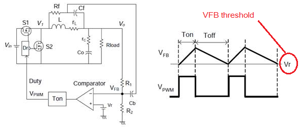

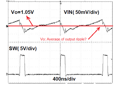

    (1) I’m understanding that VFB threshold is bottom of ripple.(Pleae see below.)
    In this case, what point is output voltage decided on ripple?
    (It is average of output ripple?)
          datasheet page 15, Figure 16
    (2) You mentioned that different condition has different ref value and for different output, ref has different threshold.
    In this case, how should I think about output voltage calculate? (datasheet page 13, Equation 2)
    I think that VFB threshold range (max/min) will be changed depending to output voltage.
    (When output become large, threshold range will become wide.)
    But, basically typical value (600mV) is not changed.
    My understanding is correct?

  • Hi Tao,
    (1)Vout is proportional to VFB+1/2 VFB_ripple. With same feedback resistors, the large FB ripple, the larger Vout.
    (2)Yes, we usually use typical VREF to design the output voltage.
