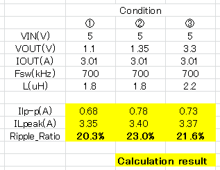

<Question>
My customer is studying the design with the following voltage and inductance value, is it usable?
① 5.0 V ⇒ 1.1 V:1.8 u H
② 5.0V ⇒ 1.35V:1.8uH
③ 5.0 V ⇒ 3.3 V:2.2 u H

    The following is the result I calculated.
    The ripple rate is "20.3%, 23.0%, 21.6%", but is this inductance usable? (YES? Or NO?)
    ① When it can be used (The answer is "YES".)
    How many Output and Feed Forward Capacitors (C4, C8 + C9) can be used?
    ② If you can not use it (The answer is "NO".)
    Will not the inductance be fixed by the condition?

    3. Yes. You can use that inductor. 22uF to 68uF is cap range.
