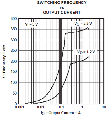

Our customer is working on the MODE of TPS62135.
They want to use PFM/PWM mode, however on the other hand, they have some concerns about how much the switching frequency falls down.
Could you share any graph for Io vs Fsw at Vin=5V/12V/17V, Vo=3.3V ?
- I look forward to “X-axis = Io” version of just like Fig73.
