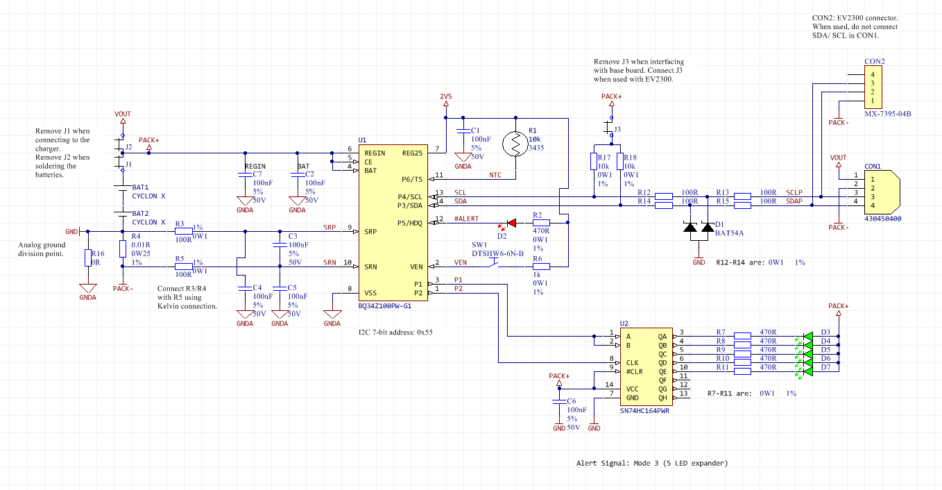

I am currently trying to figure out how to configure BQ34Z100-G1 on my testboard by using EV2300 with Battery studio. This is my boards schematics:

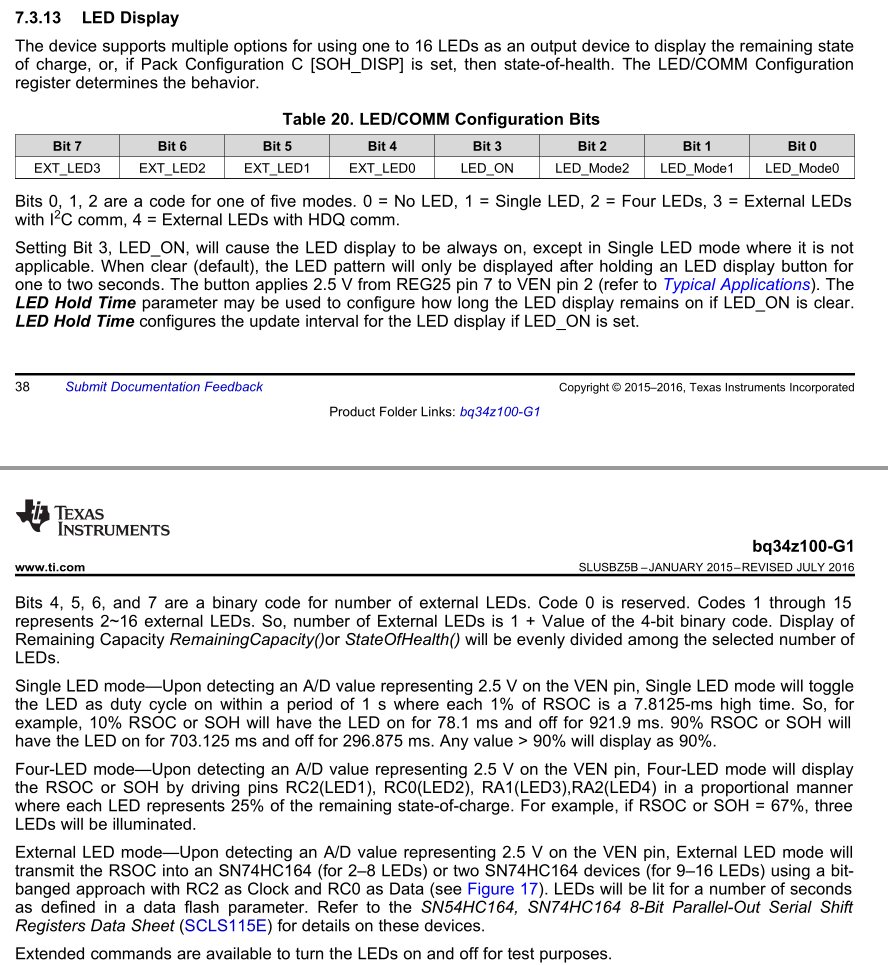

Now I am trying to turn on the 5 LED config by following the page 38 in the datasheet:

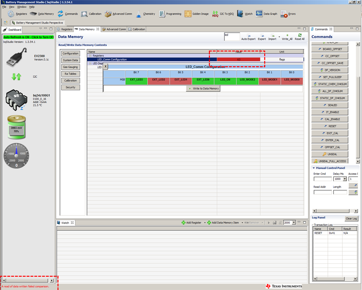

In battery studio I set the LED register as follows:
In the left down corner I get "A read of data failed comparison". I have no idea either it worked or not, because under value I see the register value I entered (is it correct). Also I figure out after whole day of searching that I have old firmware version and in order to update it, I need another EV2300... But is it the case here?
After this setting I press the button but no leds go ON. What could be the reason?
