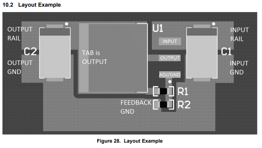

My customer has a quick question about a linear regulator:  LM1084 in the TO-263 package.
Should the OUTPUT pin and Vout pin (tab) be tied together? It is not very clear in the datasheet or layout example. LM1084 Package Info.docx
  • Hi David,
    The tab and  middle pin (both OUTPUT) are electrically connected; however, we recommend that the pin be connected to the tab by a trace for best performance similar to what is done in section 10.2 of the datasheet.
