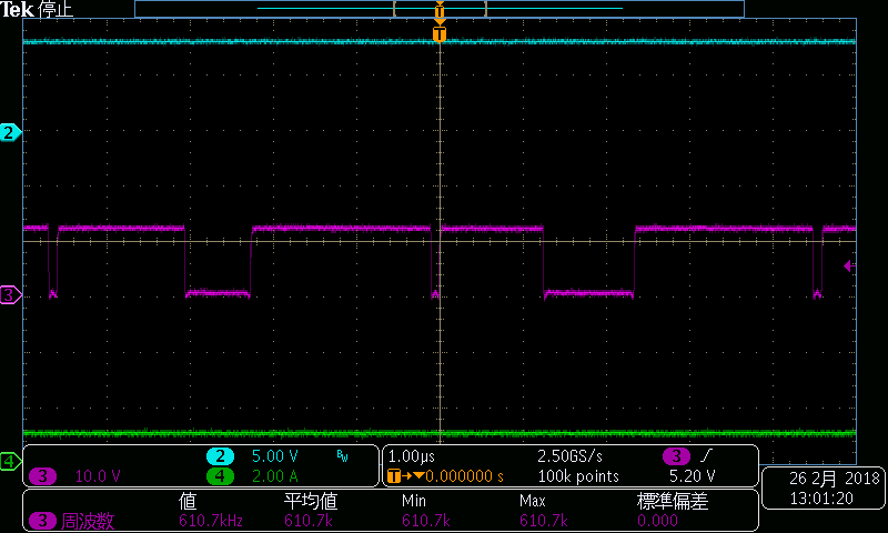

They are evaluating LM5140EVM and found big switch node jitter. Please refer to attached file.
LM5140Q1 test result_Feb2618.pptx
- Case 1 -
 Condition: EVM default setting(2.2MHz operation)
 Phenomenon: The switch node jitter of Vout2(5Vout) is bigger than Vout1(3.3Vout).
- Case 2 -
 Condition: 440kHz operation; they changed the value of external components. please refer to attached file
 Phenomenon: The switch node jitter of Vout2(8Vout) is bigger than Vout1(3.3Vout).
They assume the jitter becomes big as output voltage setting is rised. They have questions about this phenomenon.
- Why does the jitter become big as output voltage setting is rised?
- Are there any solutions for this phenomenon?

    Thank you for your question about the LM5140-Q1 jitter. Are you making the measurements on the standard or the High Density EVM? For a buck controller there will always be some amount of jitter on the switch node. The LM5140 jitter is less than 8%, so the case 1 waveforms look normal.
    It does looking line the scope leads used to make the measuring are long (ringing on the leading edge of the waveform) which may add some noise to the measurement.
    For case 2, are you in DEMB, or FPWM mode?

  • Tateo,
    Sorry for the delay responding to your question about the LM5140 jitter. As I mentioned for case 1 the jitter looks normal, you could try increasing the VDDA capacitor from 0.1uF to 1uF to see if this helps.
    For case 2 I recommend that you change R18 from 22k to 8.2k, and C7 from 47pF to 22pF. I would also try increasing the VDDA capacitor from 0.1uF to 1uF.

  • Hi, Thank you for your support. They tried your suggestion of case 2 and they could reduce the jitter. But the unstable sw-node is still occurred at 1A load in DEMB mode. And we got additonal questions.
    - What is the cause of SW-node jitter?
    - Is there any solution to fix the unstable SW-node at 1A in DEMB mode?
    tateo
  • Tateo,
    With a 1A load the LM5140-Q1 maybe transitioning from DCM to CCM. The way to debug this is to place the LM5140 in FPWM.  If the SW node waveform appears normal, it is not instability, it’s the transitions from DCM to FPWM.
