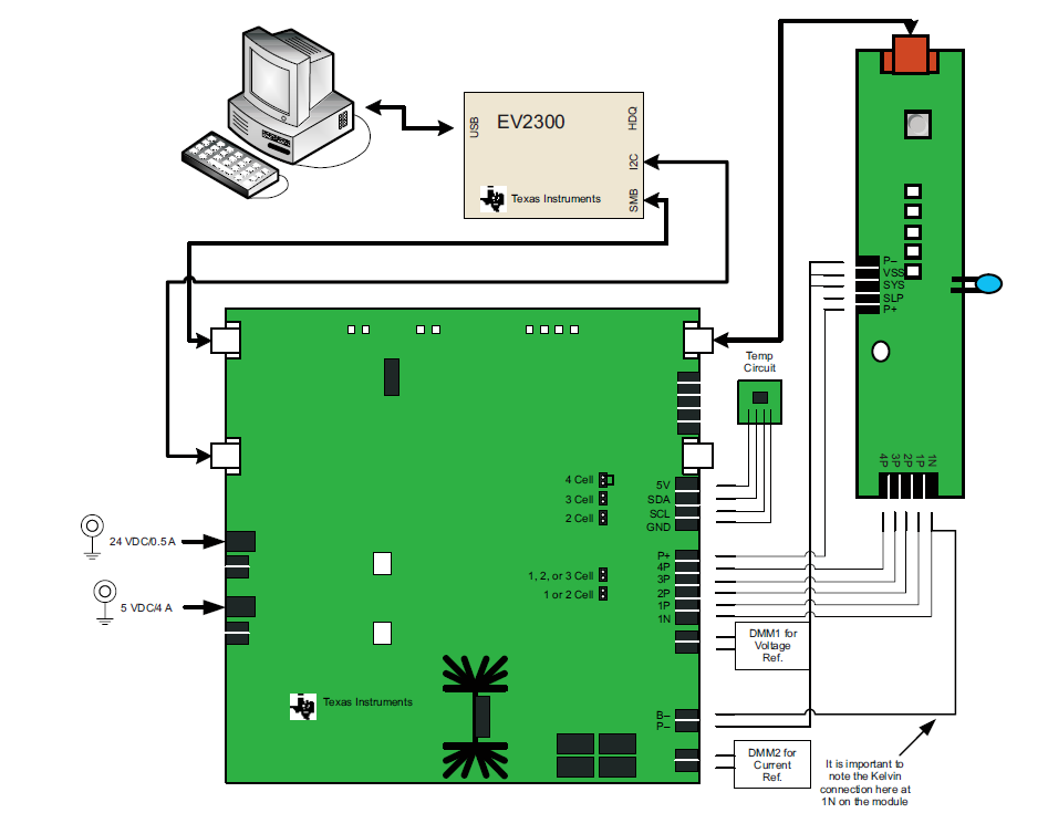

I have the HPA169 connected to my Device Under Test. I'm aware that the DUT should be able to be powered from the 20V on the HPA169 however without connecting my 18V PSU, I get a "no device acknowledge" error in bqProduction even though PACK+ of the DUT is connected to the PACK+ terminal of the HPA169. I've followed the connection diagrams as shown by "sluu238b - bqMtester User Guide"

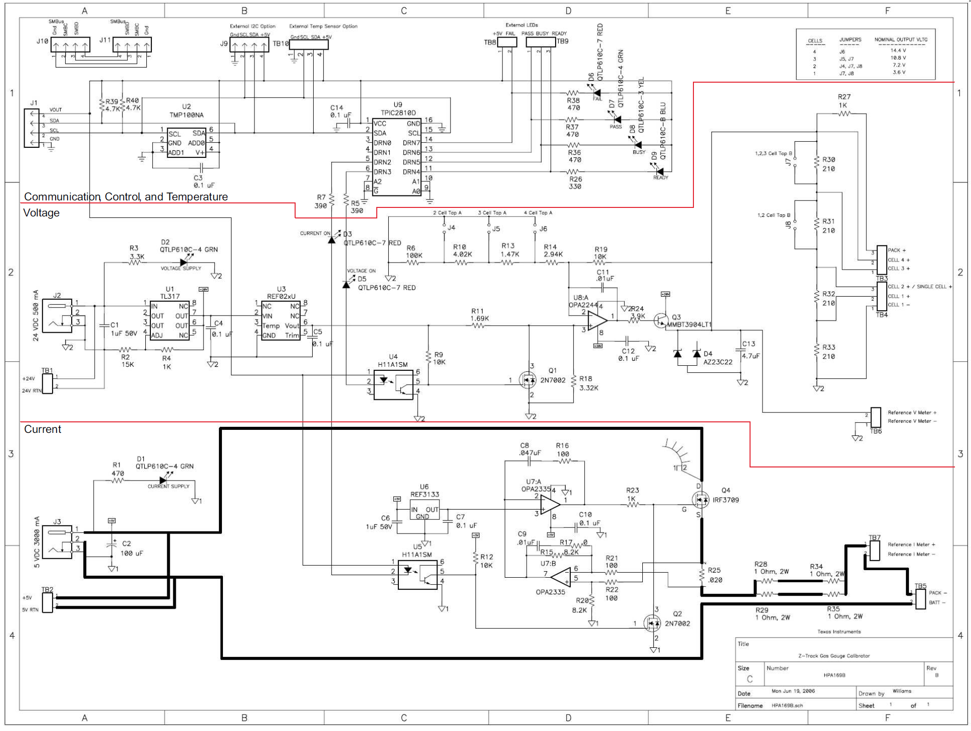

    Below is the schematic of the HPA169 calibration board i'm using
    Following these connection instructions

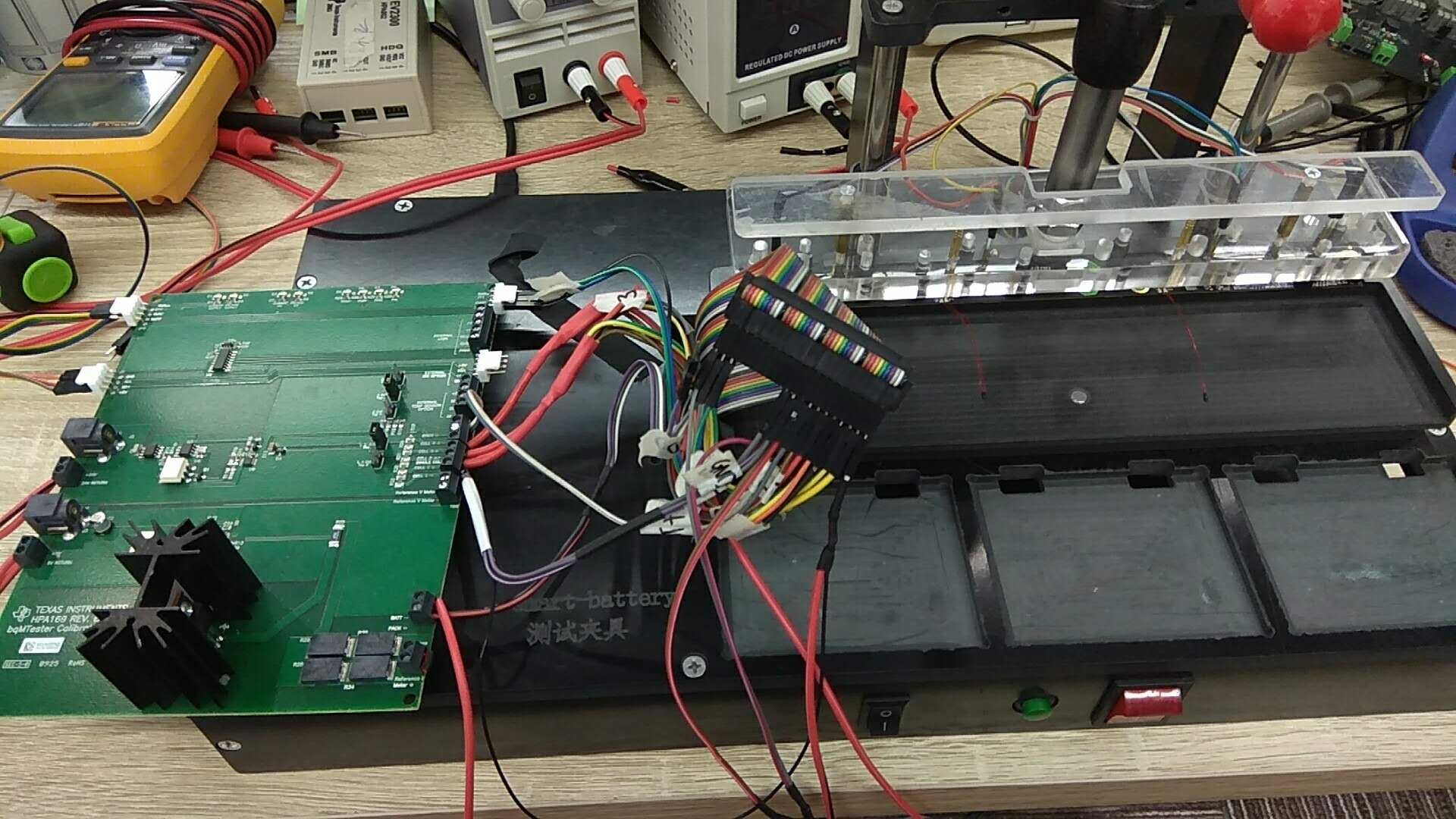

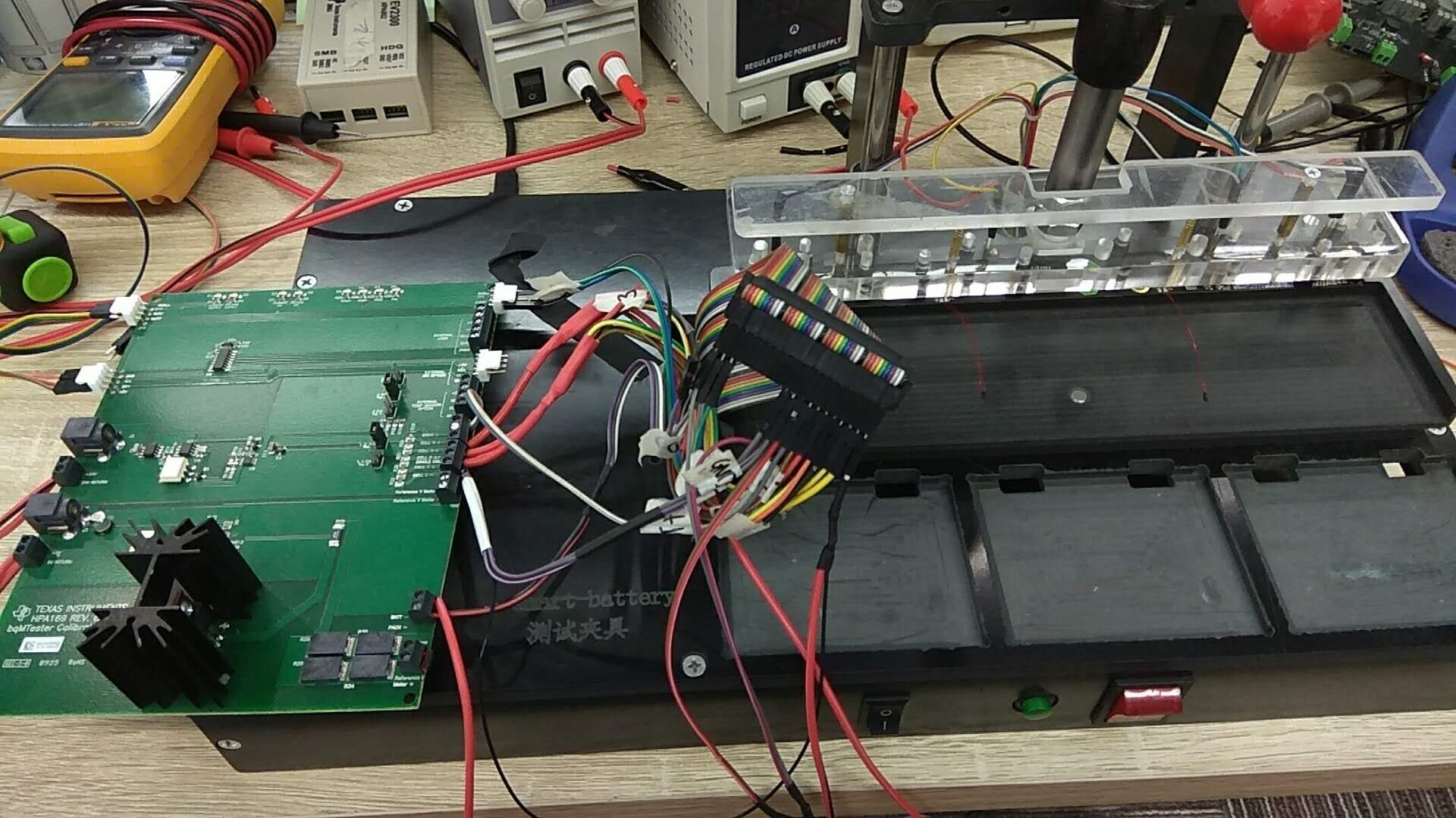

    Lastly, here is my setup, i have the calibration board connected to a jig where the DUTs can easily be placed and pogo pins connecting to pogo pads on the DUT. There are several pogo pins for each of the larger current carrying connections. I also have desktop power supplies for 24V and 5V
    Thanks for any help
