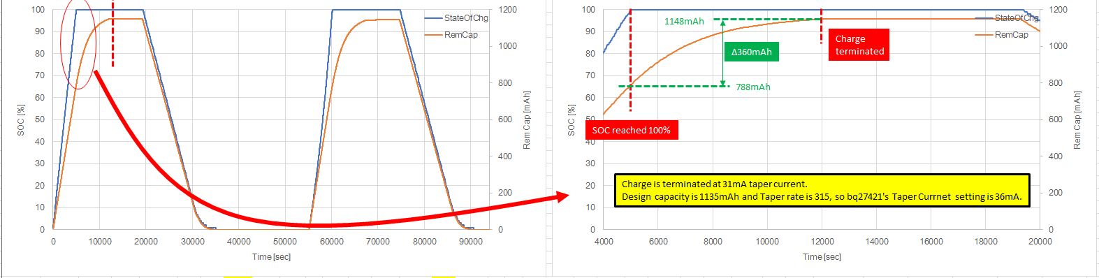

Now I'm evaluating bq27421-G1 and perform learning cycle, then I can see too early reaching 100% SOC before charge termination. I need your advice how to minimize the delay from reach 100% SOC to charge termination.
