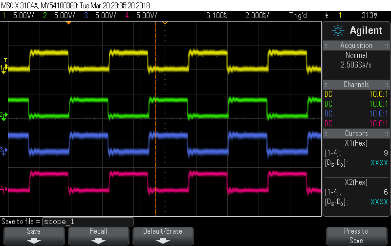

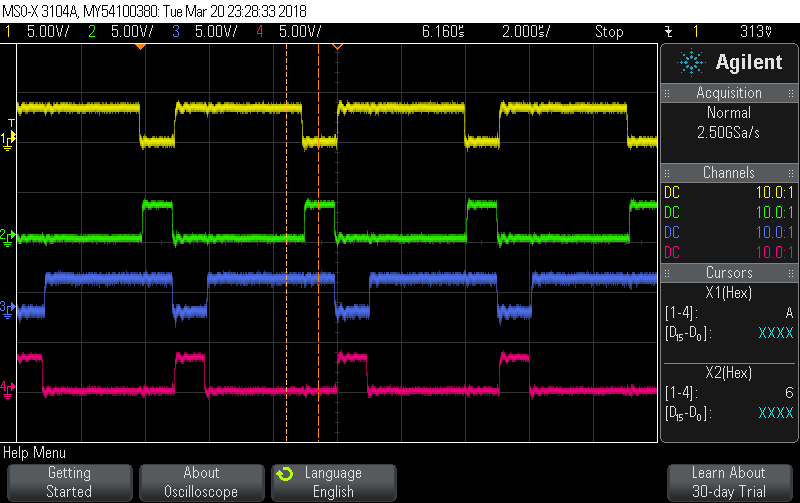

    Thanks for the update and great questions and understanding, and that’s a lot of deadtime! I would like to have a look at all 4 input signals, it seems that the half bridge is not being switched correctly. If everything is switching correctly, referring to my handy dandy 'interleaved switching waveform’ red/blue diagram you should have 2 timers driving HOA & LOB likewise you should have 2 complementary timers driving HOB&LOA, can you confirm this?

    I attached scope shots of the LI and HI signals I now have. Going from top to bottom... HIA, LIA, HIB, LIB.
    The top shot is a 50% duty cycle, the bottom is 80%.
    The ringing in the traces is due to less-than-ideal scope probe grounding,
