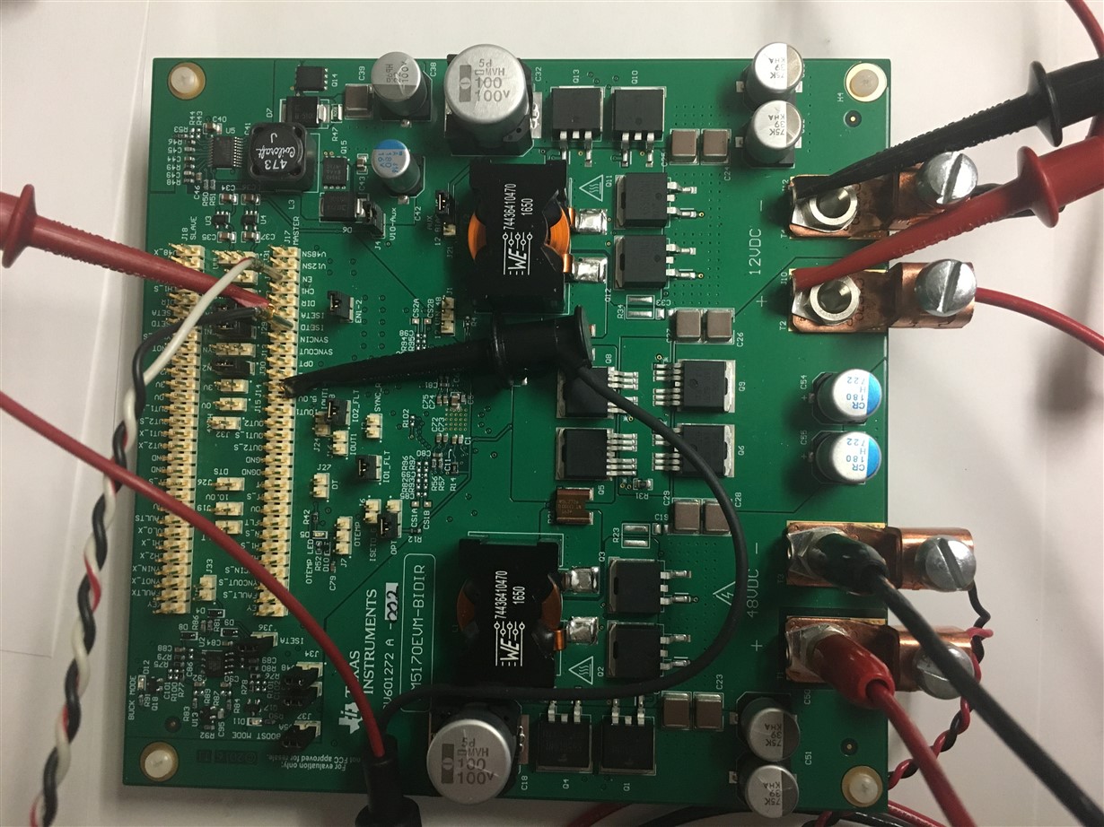

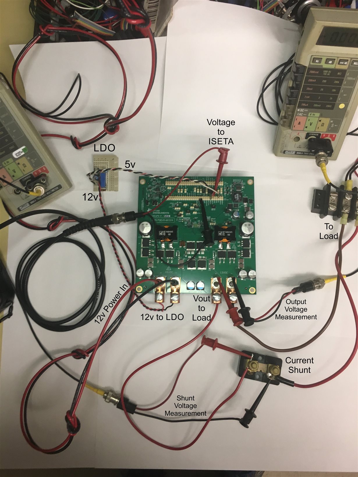

    I agree that the MOSFETS should not be warming up and this leads me to believe that I still have a configuration issue. My understanding is that MOSFETS Q5, Q6, Q8, Q9 are the circuit breaker devices and considering the low power/current that I'm controlling they shouldn't even be active. It might be useful if I could send an image (picture) of my setup with labels to you so that you could see precisely what I'm doing. Is there a way to do this?

  • Youhao,
    Here is some more information in image form showing you how I have the EVM connected to the power source, the load, and of course the control voltages.
    And here is a close-up of the EVM so that you can check how the straps are set.
    These are high resolution images that I assume you can download and zoom in on to check any detail that you might need to see.
    Many thanks again for your time and trouble...
    Dan Hagan
  • I see the issue now: you input is only 12V, which is not high enough to turn on the circuit breaker FETs (Q5,Q6,Q8,Q9). You must remove these four FETs and solder a piece of copper foil or thick wire to short the two exposed pad on the back side (beside D1).
    Please read the datasheet page 29 carefully about the circuit breaker feature. And it is also explicitly indicated that "If the steady-state differential voltage between the HV-Port and LV-Port is less than 10 V during power up, TI does not recommend the user to activate the failure detection function. Also, if the differential voltage is less than 8 V, TI recommends not to use the circuit breaker function of the LM5170-Q1 at all."
    Youhao
