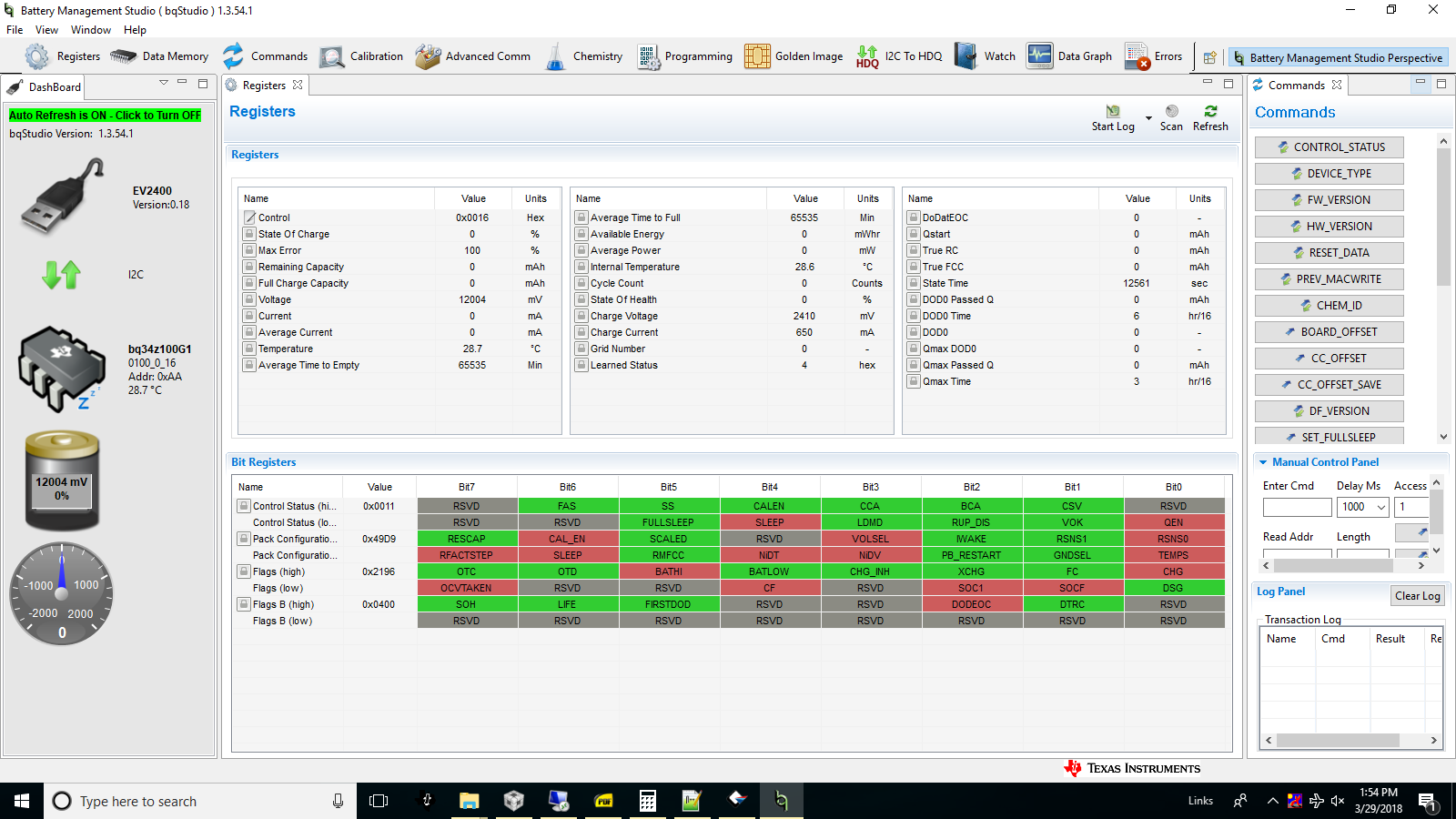

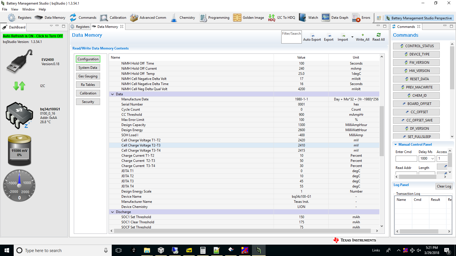

Hello Everyone,
Iam testing lead acid battery  of type 12v, 1.3Ah , iam able to get voltage by updating voltage divider value. but iam not able to get another values.
As per suggestion in posts ,
0. Configure dataflash, pack chemistry, perform calibration and export GG File (for later comparison)
1. Enable IT
2. Send Reset command (0x0041)
3. Charge the pack to charge termination.
4. Rest until the OCVTAKEN flag sets
5. C/7 Discharge to the termination voltage
6. Rest until the OCVTAKEN flag sets. At this point, QMax should update and the Update Status should increment to 0x05
7. Charge the pack to charge termination
8. Rest until OCVTAKEN flag sets
9. C/7 Discharge to the termination voltage
10. Rest until the OCVTAKEN flag sets. At this point, the Ra table should update and Update Status should increment to 0x06
I  followed dis steps, no change in values , learning status is still  in 0x04.
only ocvtaken flag is set after charging.
