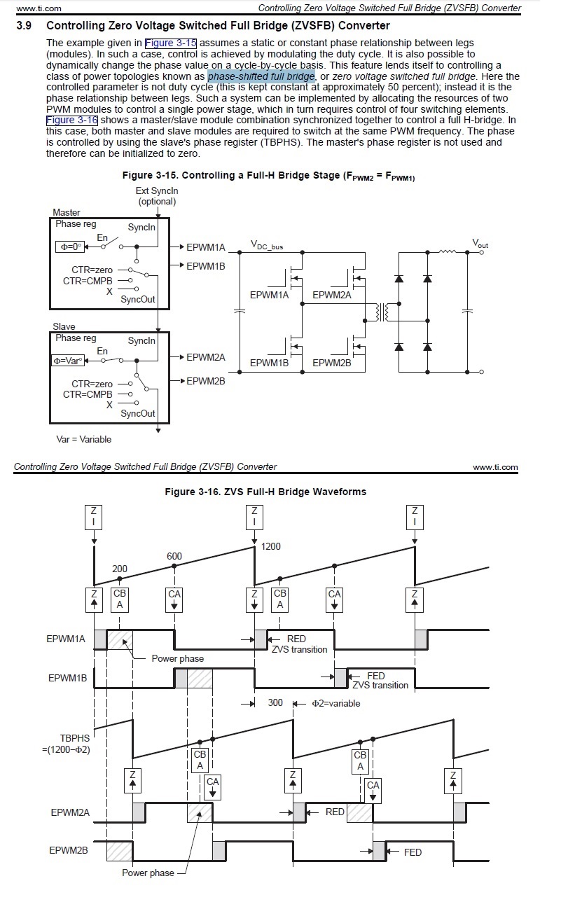

  • Hi Don,

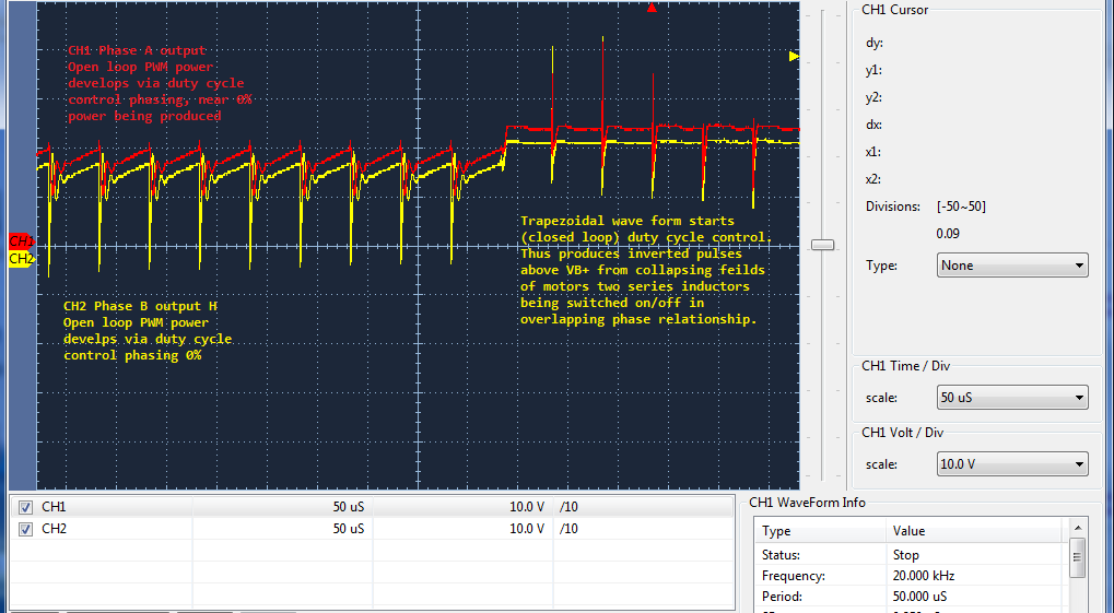

    We require three UCC for open loop commutation in Full-H bridge switching (Fig 3-16) by leveraging rapid duty cycle changes boosting / rolling inductive currents in motors stator.
    That phase shift via UCC is very little on startup (<20ns) and attempting to adjust the pulse width wider for producing inductor power in H-Bridge mode randomly causes high voltage and (pulse inversions), not overshoot.
  • Below is zoomed capture of two motor phases A/B showing overlapping from two UCC working together as a full H bridge then switching into 3 phase commutation (closed loop). Notice there is no phase shift occurring as the duty cycle is being rapidly updated in both phases even as changes are being input to HI/LI inputs. It appears the UCC HI/LI delay matching is stripping off the required phase shift from the rapid duty cycle changes. It is true each MCU PWM generator produces two center aligned overlapping signals (A/B) each with a different duty cycle. The three PWM generators are synchronized and produce the same two signal pairs previously described.
  • Seems this issues started several weeks ago by reversing HI/LI UCC #3 in software pin map, correcting that all seemed ok. Motor was able to start in open loop H bridge commutation and run in closed loop half bridge mode. Replaced UCC #3 (obviously defective) was also causing Cboot charge issues other two UCC. Previous posts were LO not able to fully charge (pull down) floating Cboot to ground in last two UCC, though 1st UCC could so it should still be ok but replaced it anyway.
    First replaced UCC gate drivers #1 & #2 noticing Cboot discharge rising slope returned to UCC #2 but still no phase shift as above capture shows. Replaced #3 and PWM is again producing required phase shift between any two phases.
  • Who would ever suspect not one but Two gate drivers were damaged by reversing HI/LI for short time to one gate driver? Reversal of HI/LI is a common occurrence in past has never damaged the HO/LO outputs of other vendors gate drivers. Oddly the MCU driven PWM is only producing 400-500mA and peaks of 2A during motor run.

    Perhaps you are correct as we did also connect inverter to a larger motor 12.5Khz and it would not start, only POR's MCU several time. That may have been what caused UCC to fail as being described below.
    Same failure of UCC occurred again, after attempting several times to get large motor to startup at 40Khz (25us) PWM frequency, as smaller motor could easily do. Our inverter FETS have similar QG of IGBT module used TIDA-00778, so we used very same GTRon/off  resistance values shown in schematic. UCC HO/LO drives had GTRon = 6R,  GTRoff = 12R . Perhaps the TIDA engineer miscalculated total QG of the IGBT module relative to UCC to produce IGPK +/- 4amp <10us pulse shorted to ground. Otherwise it seems an anomalous condition can occur relative to the EN pin which destroys the gate drivers HS pin internally when even half QG is expected on HO drive.
    PWM pulses HO/LO in first 250us produce (0-5us leading into 20us pulse widths) and MCU quickly shut down EN pin as over voltage was occurring on DC bus PWM 40Khz (25us) pulse widths. We then doubled GTRon/off resistance values and reduced HO output drive by half. We noticed the charge pump seems to over drive HO during LOW voltage testing UCC @24vdc thus producing high voltage peaks in the DC inverter connected phases.
    It would seem datasheets  IGPK +/- 4 amp <10us pulsed to ground specification is questionable under low voltage drive conditions of HS, when EN is suddenly disabling HO by MCU control. This seems to destroy UCC HO drive yet there is no specific ohmic or diode drop difference (HS-HB-HO) detected on a failed UCC. Once the IC has failed internally ? it then causes (excessively) high voltage to be produced on the DC bus from HS float jumping up to B+ rail. We were seeing +180v produced from +24vdc power supply with large magnet motor, such large potential spikes quickly POR the MCU after gate driver failure occurs. The total QG formula used to calculate HO/LO drive seems to miss the target by a mile under the conditions listed here.
    Failed UCC capture: HS pin will not pull down during Cboot charging via LO driving NFET. HS appears to jump up to HO after Cboot actually being kept in a charged state from HS leakage. So LO can not pull down a floating Cboot in this capture below, resulting in high voltage inverted pulses being produce by HO driving NFET's.
  • CH2 phase B second capture is a defective UCC. Notice horizontal lines between pulses seem to indicate Cboot is not being discharged by LO.
