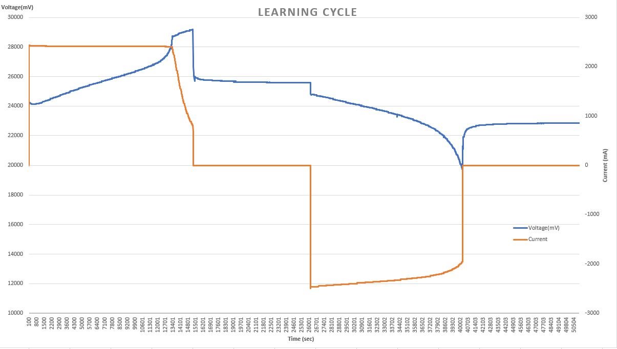

  • I checked the ChemID with GPCCHEM and changed to 0807. (0803 before)
    But i have still the same problems, i discharge the battery and after some minutes the SOC jumps to ~ 15-20%.
    Was there a problem with the Learning Cycle? I use the GPCRA0 with the attached log.
    In the log the OCV at 0% SOC is 22800mV. If i discharge with higher current i cant reach this Voltage (SOC 0%  23100mV) . What i can do that the IT-Algorithmus works properly? i set the cutoff voltage at a lower level to discharge longer with higher current.0247.GPCRA-report_OUT_(2).zip2313.GPCRA_(2).zip5037.CONFIG.gg.zipLOG_Learning_cycle_LC-RA1212_4.zip
  • The purpose of learning cycle is to update Qmax Cell 0 and Ra value.  Accuracy test should be conducted after learning cycle.
    SOC 0% happens before reaching at terminate voltage since RM/FCC is predicted value under load,temp and voltage. As you use higher current, it reaches at 0% earlier at higher voltage.  SOC jump down or jump up can be happened if your chemID is not matched with your cell , resistance table is not correct, Qmax value is not matched or load select is not set properly different with your load test condition and so on.
    Did you use the aktuell.gg.csv file for your test ? It has a lot of wrong value - 175.
    Here is the condition to test the cell.
    1. Find the correct chemID. What was your GPCChem results ? Was max DOD error below 5% ? What was the max DOD erorr ?
    2. If chemID is matched then run a learning cycle  => It will update Qmax and Ra value. GPCRA gives Qmax and Ra value matched with your device. Update status will be updated to 06
    3. Once you complete the learning cycle, apply Qmax and Ra value to your gg.csv file
    4. Load mode and Load select set. Does your system use constant power or current ? Most system uses constant power mode if there are many switching power devices like buck or boost converter.
     Select a proper Load select
    4. Discharge cycle test after full charge termination =>  Update status should be 06.
    5. SoC jump after full discharge would be happened when OCV is taken during relaxation if relax voltage is goes up a lot than termnate voltage. If the gauge was tested at higher load current condition, SoC will jump up more because OCV voltage will be higher.

  • The wrong values was a problem with the export-file.
    I follow your introductions 1-4.
    I did this several times but i never reach learning status 5.
    Start with default gg.csv file and modify for my battery (two serial Panasonic lc-ra1212pg) and update CHEMID to 0807.
    1.)  I charge the battery full and relax for some hours.
    2.) After that im Send IT_ENABLE and RESET and start discharge with C/8 to empty and relax for 5 hours.
    3.) Charge with C/5 to full and relax >5 hours
    But the learning status stays 4. What went wrong? i have no ideas what i can do.
    Here my log file: 4834.LC.zipLC-RA1212.gg.zip
  • Thank you for the Support the learning cycle was succeed
