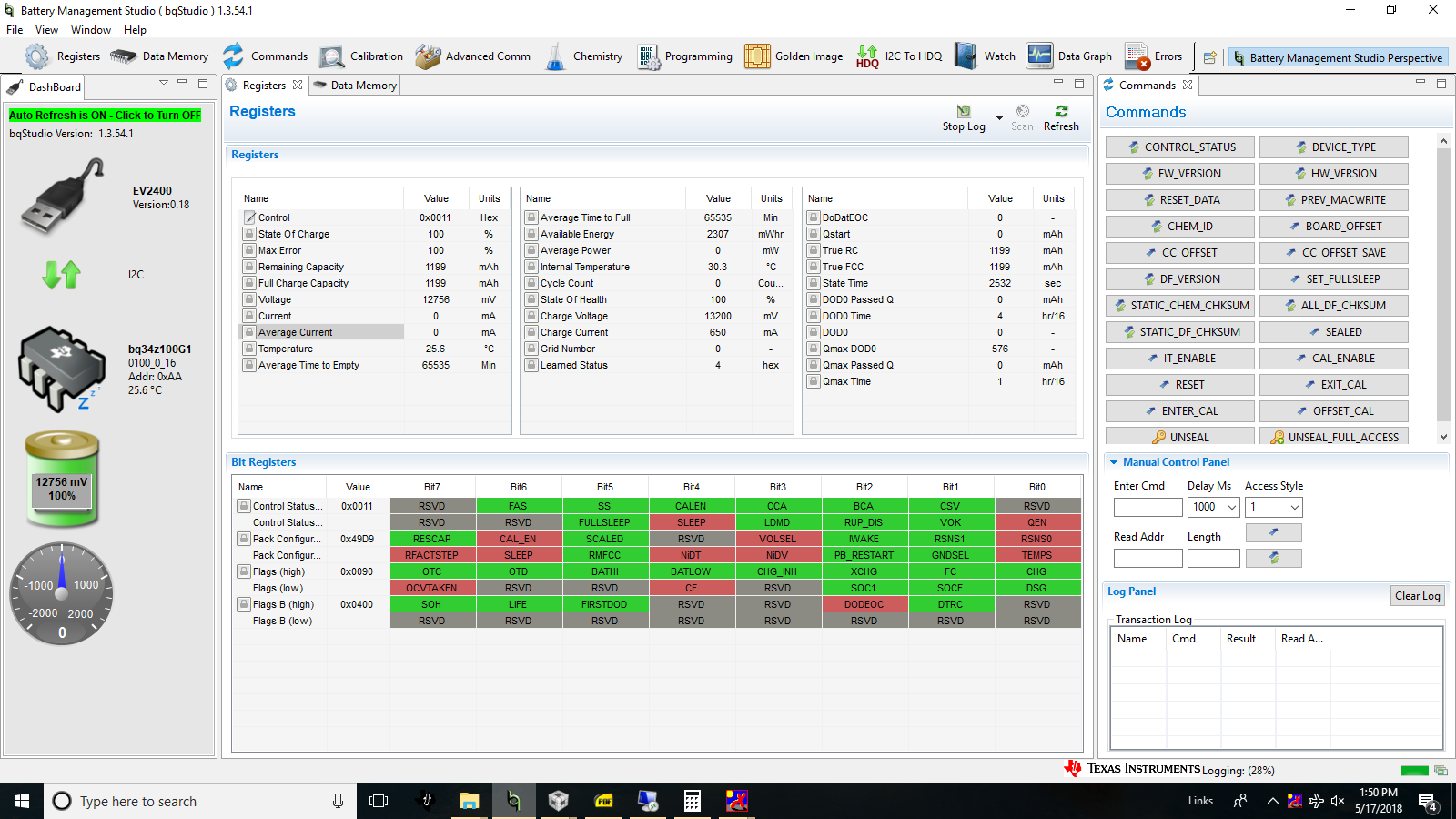

iam testing battery of type  : lead acid .12v 1.3Ah.
before starting learn cycle , after updating all parameters in bqstudio, full charge capacity is updated to 1200 Mah , but it should be 1300 Mah.
please verify my gg file, what parameter is required to update exact value. i  attached the gg file  and battery datasheet.4353.0207.Amptek_battery_12v_1.3Ah_datasheet.pdftest_gg_file_7_may_18.gg__chg.rar

  • hi david ,
    My problem is .. full charge capacity is 1300 Mah , but it is showing 1199Mah...
