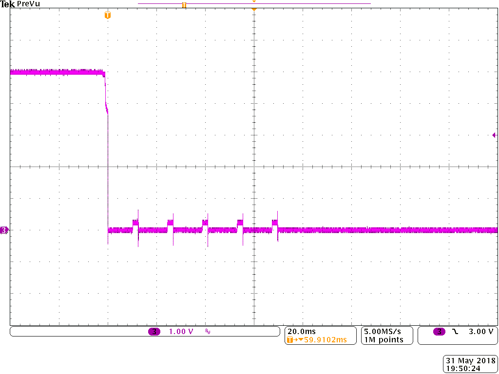

I have question about overcurrent behavior of TPS55160-Q1.
In my understanding, the behavior when overcurrent occurs is as below. Is it correct?

Hello Helen-san
Sorry for delay response.
Seeing Data Sheet Fig15 state diagram,
it seems that the flow from normal to prelamp is not written.
Is the state transition as follows?

Hello Helen-san
Thank you for quick response.
Are the state transitions the same for the following faults too?
・Overtemperature Protection
・Overvoltage Lockout
・Vout Overvoltage Protection
Tomohiro Nagasawa
For OTP, there's no 5 times limit. always OTP-> recover-->OTP--> recover.
For OVP, there's 5 times limit. after 5 times OVP, the device latch off.
