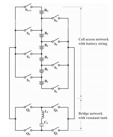

I need to implement an Active cell balancing solution without using an external voltage supply of 12 V as in the case of EM1402 EVM.
Therefore I was thinking of using LC Series Resonant Circuit based Balancing. To implement this I need 2N +10 MOSFETs for N cells.
I need a switching frequency of about 50 KHz. Is there any IC available which can drive multiple  MOSFET together.
Also, Is there any way I can implement this I combination with BQ76PL455 EVM?
Figure: Active Cell Balancing of Li-Ion Batteries Using LC Series Resonant Circuit
