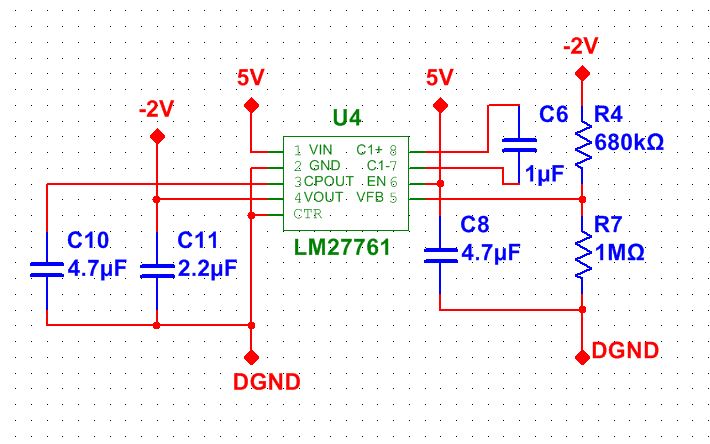

Hello. I am having problems with LM26671 regulator. I have input 5V, and want to generate -2V output with current draw of about 1mA.

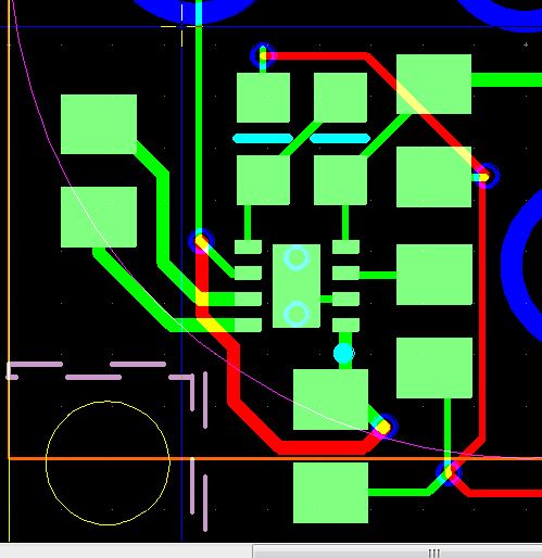

I have the schematic and layout here.
What I am seeing is, after powering out, I would have output at -2V for some time, and then the output would go to 30 mV (VFB 10-20mV), and I can feel from the bottom of the board, the component is overheating.
What is the problem here?
Thanks very much.
I am attaching

    I cannot see how the IC GND vias connect to the other GND vias. Do you have an internal GND plane on another layer or is this a 2 layer PCB? In any case, with any switching regulator we need a short and direct connection between the caps and the IC. You could order the EVM, with its known good layout, and see if it works for you.
  • Hi Lizi,
    Can you share how the GND vias connect to each other?
