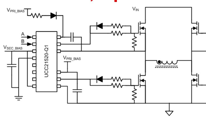

    T2, T3: are basically the transformers used to isolate and scale the gate drive, TI has released much efficient isolated gate drivers which can replace these transformers, I suggest using UCC21520 which is a dual channel gate driver; you will need two of these for GATE A/B/C/D.

    The application of the isolated gate driver is relatively simple and straightforward. Please refer to the application guide and user guides attached below, this will help you to integrate UCC21520 with the design.

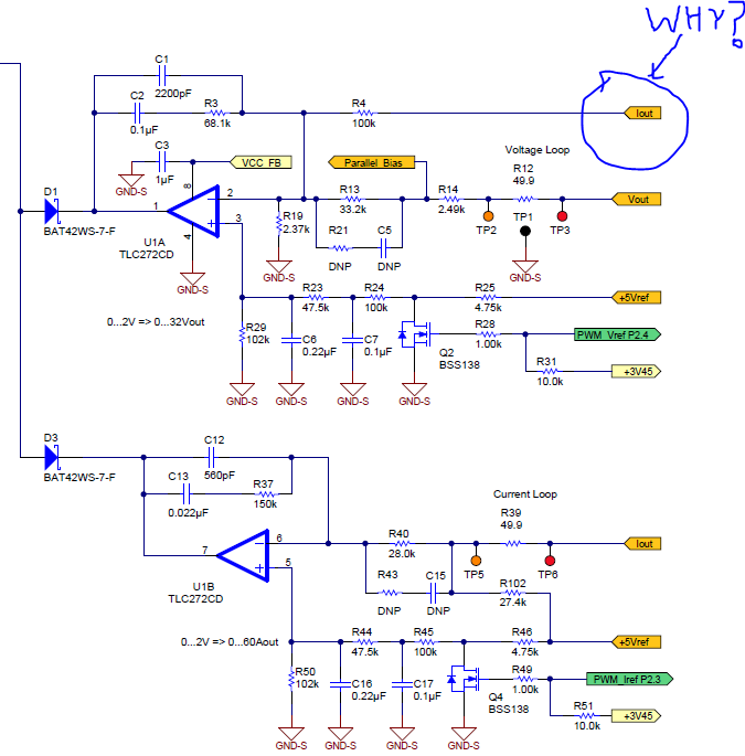

    1) why Iout signal used in voltage loop? Iout used in current loop as well as in voltage loop.

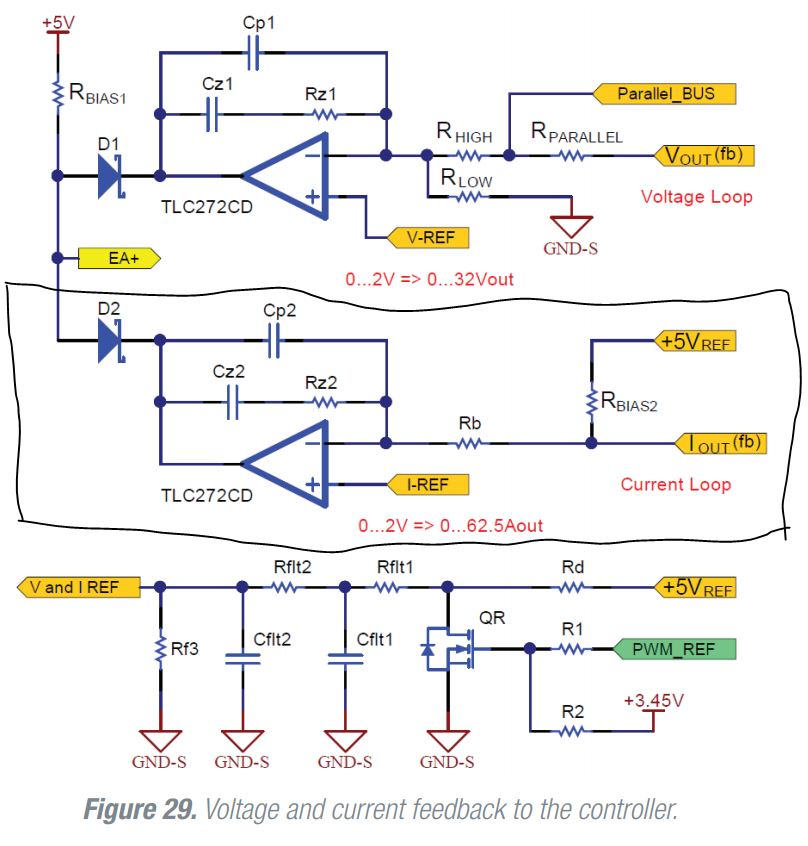

    1.  the Iout signal is used in the current loop alongside the voltage loop only to set the current limit, we cannot use the primary current signal for CI regulation because the primary current is a function of the input voltage and there is no fixed relation between primary and secondary current. This is why we need additional current error amplifier to set a demand level (EA+) for the control loop and so regulate the output current

    1)I am clear about  fig 29 . voltage and current feedback to the controller, but please explain, in PMP8740 why this Iout signal used here in this voltage loop?

    1. For the first question, R4 creates a positive output impedance and let Vout droop a bit in respect to Iout. This method helps to stabilize the parallel between modules when the battery impedance is very low.
