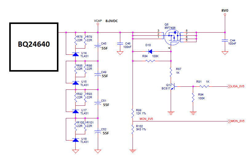

I’d like to use the IC BQ24640 in my project with the following hardware characteristics:
Vin = 9.0 to 15.0VDC
Max Input Current = 700mA
Vout = 8.0VDC
Icharge = 500mA
Supercap = 4 x 55F @ 2.7VDC (serie)
Does BQ24640 meet my requirements?
When Vin = 9VDC the BQ24640 can assure my Vout to 8.0VDC?
The maximum input current from the source is 700mA and I cannot overcome this limit.
Could you help me to calculate the value of the inductor, RSR and output voltage regulation resistors?
