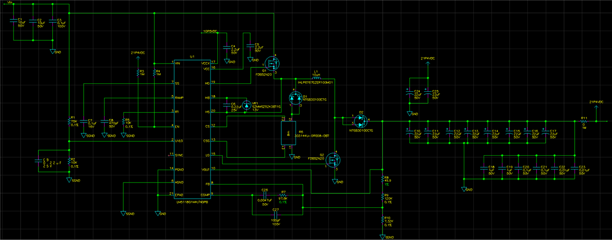

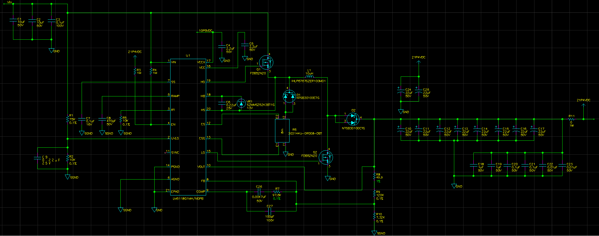

  • I don't remember ever seeing your schematic. Could you share it so we can have a review.
    Youhao
  • Sure, Youhao.  I've attached it to this reply.  I forget what exactly I did last time to make it so it was visible to you, but I'll see if this works.  Let me know if it doesn't work and I'll try a different way of loading the graphic.  A couple notes on the schematic:
    1)  As specified in the datasheet guidelines, SGND and GND are connected together at a single point.  Their connection is not shown in the schematic but is implemented in the layout.
    2)  The high-resistance feedback connection to EN is implemented in order to prevent the circuit from shutting down during brief under-voltage transients.  I should note that the circuits exhibiting the behavior in question were not subjected to under-voltage transients.
    John

  • Hey John,
    Is it only at VIN = 28V that you see this issue? Reviewing the schematic I don;t really see anything that would cause an issue as you describe. Can you please post the picture of the load transient? It would be good to also probe the COMP pin and the inductor current if possible.

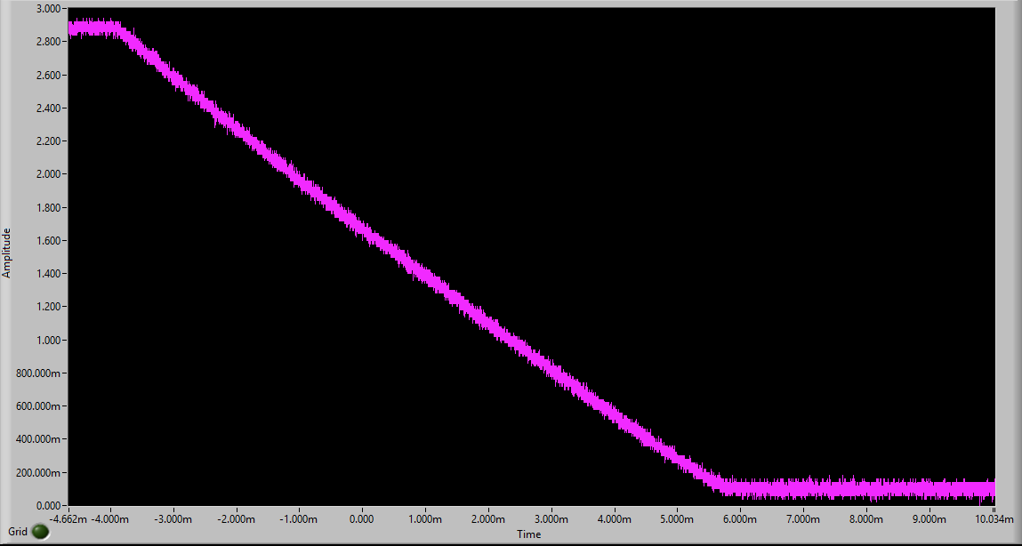

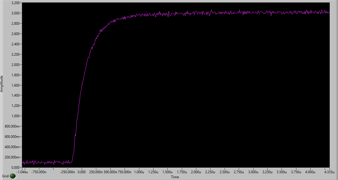

    Thanks for the reply. This behavior has occurred at input voltages ranging from about 27.4V to 28.2V. Granted, at the highest end of that range, the voltage doesn't dip the few percent, but it still has an excessive spike when removing a load, compared to normal behavior. The original thread has some more information and waveforms of the regulator output. However, I don't have the load transient itself captured. I can say that it's a fast on transition (in my benchtop tests, the heavier load is turned on by me connecting its return lead to ground while the regulator was running, even intentionally causing come bounce to see if the regulator handles it normally without excessive spikes, which it does at input voltages higher or lower than the range specified above) and a slow off transition (taking a few milliseconds to decay to zero)
    I'll work on getting a waveform of the load transient and perhaps the COMP pin. I don't have a way to get the inductor current. May not be until next week sometime. What kind of sampling rate are you looking for on the COMP pin? This test is normally over several seconds, so a great sampling rate isn't as feasible, but I can try capturing snippets at a time if needed to increase that.
    John
  • Hi Garrett,
    I wasn't able to get specific data from a failing circuit, as it turned out that I no longer had access to one that had failed.  But I was able to still capture the load transient that leads to this behavior.  It's a fast on and a slow off transition.  A slow off transition scope capture would probably have had a short spike in its current due to the spike in regulator output voltage, but again, I was not able to capture that.  Anyways, here are the rising and falling load transients.  Vertical axis units are Amps.
